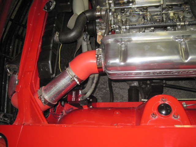

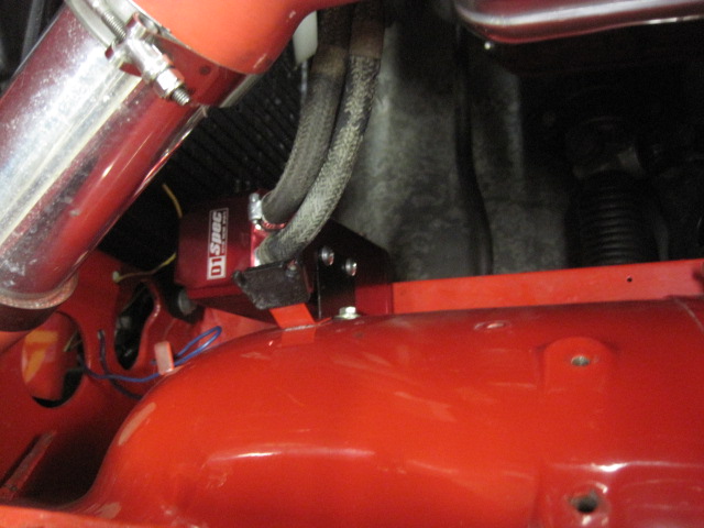

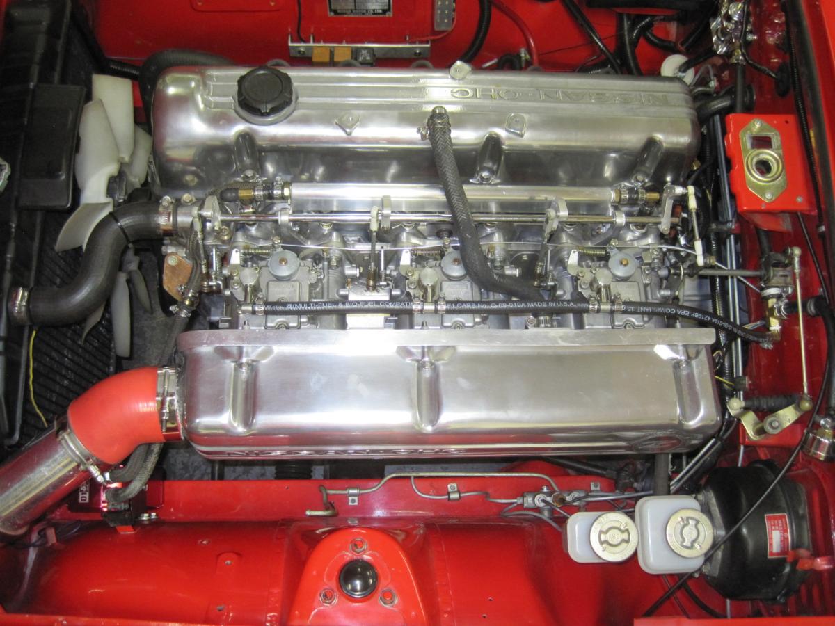

My latest version of my triple Mikunis include a new location for the pcv and adding a oil catch can. I also moved my MAP sensor all the way back to the brake booster hose, which seems to work well enough. What really
turned out cool was the luckiness to be able repurpose some old braided
hoses I had laying around. I needed formed hoses for all the weird angles
The pcv valve was moved for several reasons. The biggest being that the
oil and crap being pulled from the crankcase was condensing inside my
vacuum log and filling my MAP sensor vacuum hose that was at the low
point. I also wanted to center the vacuum leak created by the pcv to
the center instead of being off to one side. The pcv seemed to want to
make the first carb run leaner.
Speaking of the PCV, I have learned a little about them lately. Mostly
that they are not created equal. Might seem like a no brainer, but I
thought most of the differences were because of packaging reasons.
So I was running who knows what kind of PCV, but it wasn't Datsun
approved. What I had going on was a PCV that was allowing considerable bypass at idle. So I had a sizable air leak right at idle, vs. the stock
PCV that closes off at idle. This could equate to almost a 1/2 turn or
more of mixture at idle . Is this a bad thing? Jury is still out.
I have more investigating, but I think the car idled better, started
easier and ran cleaner at idle with the wrong PCV. Someone want to
explain the science behind that for me:)
Good thing is that despite some richness on the 5&6 at idle or pilot
circuit, carbs run good and plugs are a beautiful tan!
