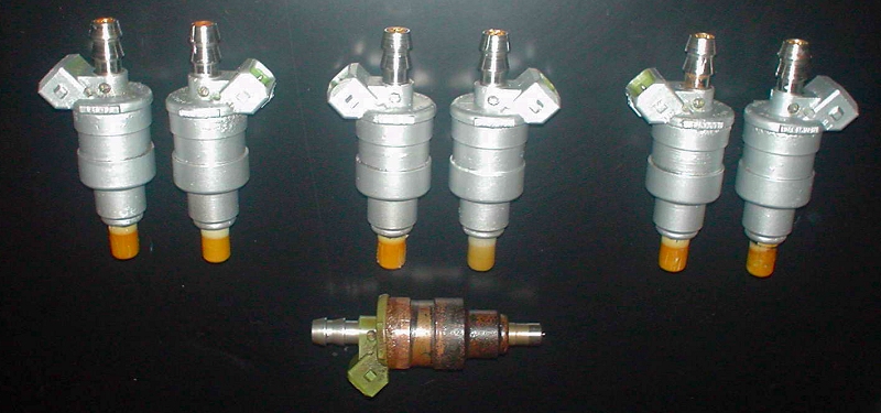

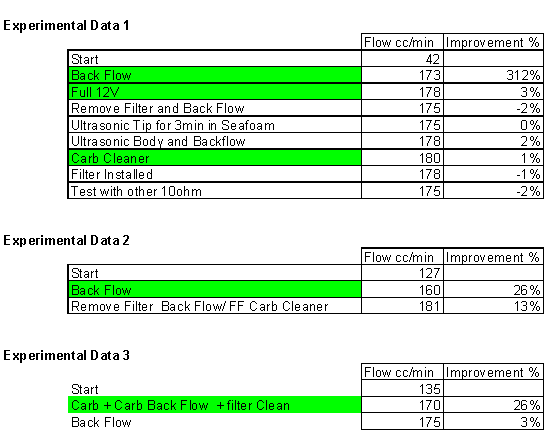

Here is old data that I collected 5 years ago:
"Lab" Notes
  1. Pintle Cap affects spray pattern when not fully seated
  2. 20 ohm vs 10 ohm vs 0 ohm current limiting shunt affects flow data
    - Example Experiment:10ohm gives 173cc/min and 0hm gives 178cc/min
  3. Filter presence changes pattern shape
  4. Back Flow with filter in makes biggest improvement when cleaning a poor flowing injector

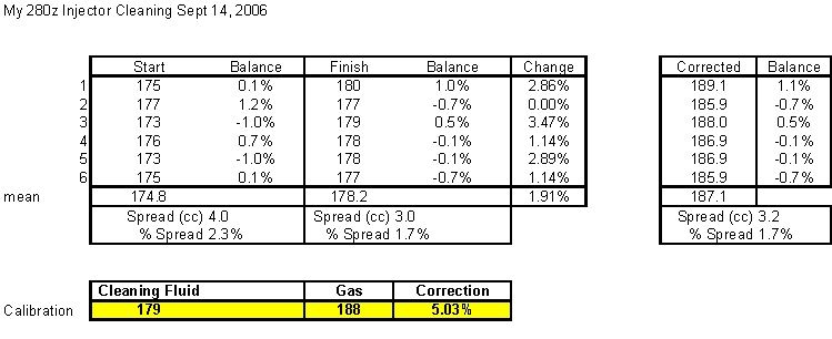

  5. Cleaning fluid flow rate changes over time (use gas on final calibration test)
    - Example 177 cc/min with cleaning fluid = 188 cc/min with gas (6.2% increase)
  6. Electric Fuel Pump Pressure changes over time and the recirculating fluid temp. increases slightly.
  7. Best Cleaning Technique:
    1. Measure Flow
    2. Remove Pintle Cap and put it in Ultrasonic cleaner
    3. Backflow using 250cc of cleaning/test solution
    4. Remove mesh filter and put it in Ultrasonic cleaner
    5. Backflow using 250cc of cleaning/test solution
    6. Manually forward clean injector using direct spray from canned carb cleaner's straw then soak in cleaner while manually activating the injector open and closed for 1 min
    7. Manually forward clean injector using direct spray from canned carb cleaner for 30sec with the injector open to flush
    8. Pull mesh filter and pintle cap from ultrasonic bath and back spray filter mesh with carb cleaner
    9. Install filter and pintle cap
    10. Flow test
    11. attachment.php?attachmentid=50552&d=1326691390

During that summer I did the same tests on my Toyota Echo.
Cylinder 1's plug colour showed leaner than the rest and an initial flow test confirmed this lower flow.
After cleaning, all the injectors flowed the same. After 800km of driving, I re-checked the plugs and all looked the same.
