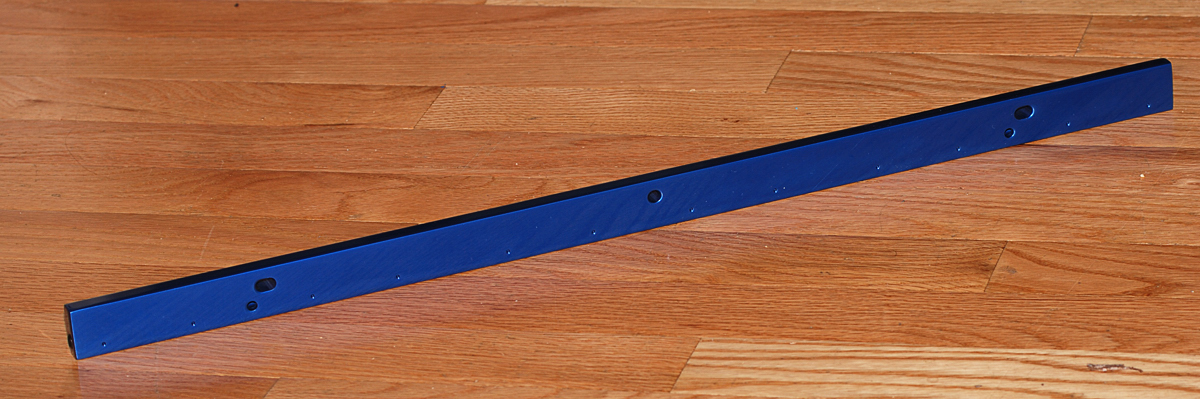

I'm in the process of assembling an engine and I need to know whether or not to put some sort of gasket material on the spray bar to cam tower joint. I want to make sure that I minimize the oil leaking out of the joint. However, RTV makes me nervous as it may break off and plug the spray bar holes. I wasn't able to find any mention of a gasket in the FSM. Anyone have any experience with this?

Just use the cheap felpro gasket paper from any autoparts shop and cut new gaskets to fit the margins of the tube with appropriate holes for oil flow..
I happen to have a 1976 spray bar in a box in the garage and just took a look at it. It does have a gasket at the interface. Not a precision piece, essentially a square of gasket material with two holes, one for the oil and one for the bolt. Pretty sure the head has never been touched.
p.s. don't forget the hole for the oil.

After taking a closer look at the spray bar I don't think a gasket made from parts store gasket paper would work very well. The spray bar is only held on with one bolt per cam tower. If I put a semi rigid gasket material in the joint I'm afraid that it would compress at the bolt and not at the oil hole. It may even cause the oil bar to deform. If the oil hole had a bolt on either side then the gasket would likely work fine.
I'm considering removing the spray bar and blocking off the holes. The cam that I'm using is internally oiled. I bought it from Rebello. Dave recommended that I run both spray bar and internal oil system at the same time. However, after reading about several spray bar failures, I may be better off to use the internal oil system only. I'd rather have all of the oil going through the cam rather than risk having some or all of it leak out of a broken spray bar.

p.s. the flat head of a good bolt should (did, in my case) provide enough pressure to seal the spray bar, with gasket, to the tower. The pressure in the bar is reduced due to the oil-jet restriction. The gasket on my 1976 spray bar was well-compressed and showed no signs of distortion or leakage. It was smashed flat like a typical old gasket, very evenly. No signs of uneven load.
