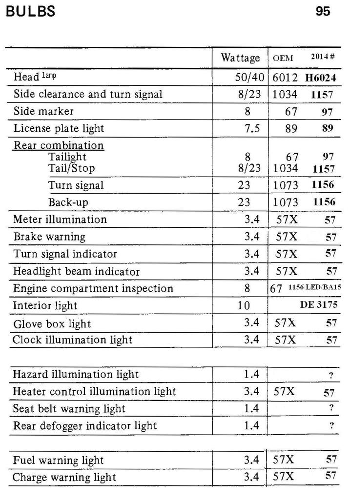

I'm updating my list of replacements, and the only bulbs I can't find are the ones in the defroster/hazard/seatbelt indicators. Is there a bulb number for those? From the look of the old bulb, it seems like an LED would fit just right.
