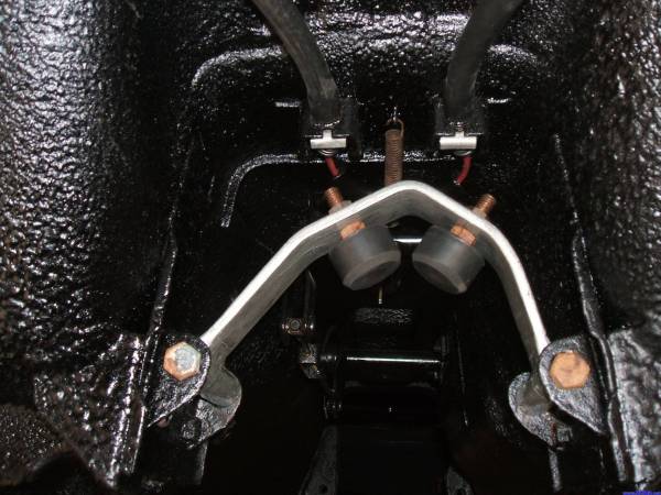

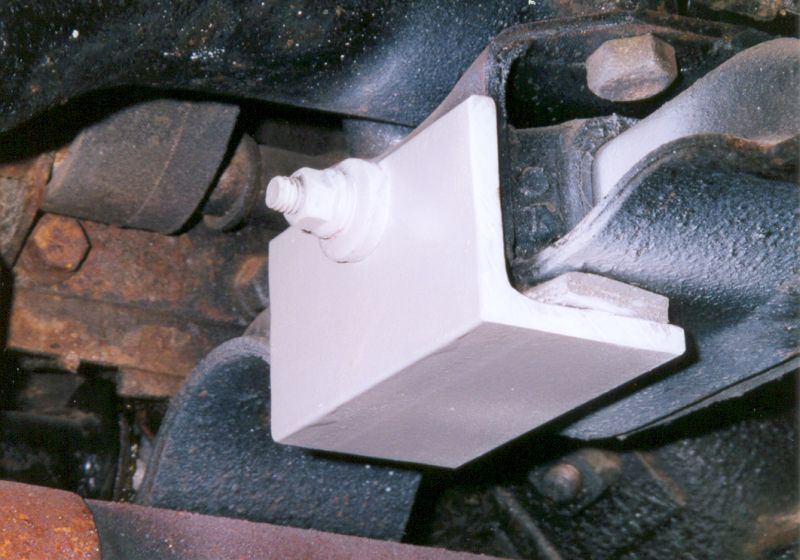

Running stainless steel strap/banding under the differential neck (between the differential and the front mount) then wrapping it under the cross member and binding the strap there will do the trick and come in as the most lightweight and economical solution. Some correctly placed rubber and voila race ready strapping differential.
Here are two other variants I like:
Had I seen these before, I might have considered them. I did not. I did want to lower the nose of the diff in order to improve my drive shaft angles..I have a hybrid with a T-5.
Blue, Where were you before I put the RT mount in my car? but it was easy to install and it worked. I suppose I could have just thought about the diff movement before ordering it and gone the L stock route. Anyhow, what were they thinking with the strap, it was poo.
