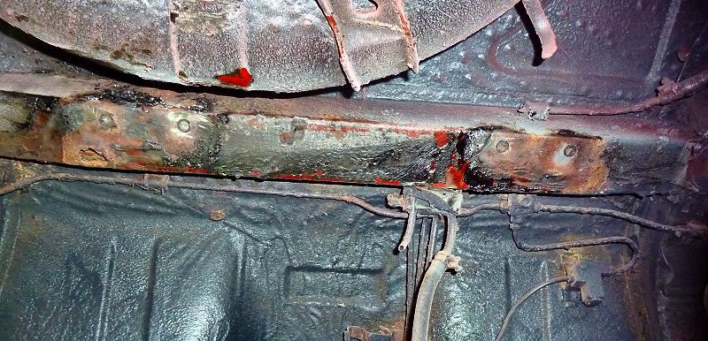

Hi,
The 4 bolts that hold the two differential rear hangers to the box frame cross beam broke when turning out.
I tried PB blaster and heating the remaining studs with a MAP torch, quenching and turning out with an extractor but no luck.
Today I had a welder with a 120V flux wire mig have a go but the welds would not take to the studs. They broke when turning. He also had problems welding the nuts to the studs... the washer seemed to weld ok. It seemed like the nuts may have been a poor quality steel... not sure?
Any tips on how to do this job? Does it need more heat with a 220V higher current welder?
Thanks

The parts are the four bolts that hold the two vertical flat steel plates that run on each side of the differential's rear cover. These bolt the plates to a box section cross beam under the rear hatch's floor. (see attachment for gory details) and photo of what it should be.
I tried drilling but no luck... could not drill into the hard steel. I think I may have hardened the bolts by heating then spraying with canned freezing spray.

OK :mad:, that looks like fun :angry: not! It's too bad the car is not on a rotisserie but that does make more sense now that I see it. I agree they will have to be drilled out. Which could be a real chore from under the car on your back. I would also try not drill the whole bolt at once but step up. If it gets off center some times the tap will pull out the partial thread. The bolts are probably pretty hard from the factory, but the quenching may have worked against you. I don't think you have an easy fix :cry:

I am tempted to cut the whole darn box section out and replace with a re-fabricated one or graft in one from a donor car.
Blue,
If your up for that just cut a section out for both bolts (maybe 2"x5" for each side), plasma cutter if you have it or die drinder, might need a 90 degree die grinder to get access. Get the bolts out the back side once it's out, then make backer plates for both areas. Put some holes in the bolt plates and around the perimeter of the hole (5/16" dia). Plug weld the backer plates into the boxes first, make holes for the suspension boltsa to pass into, then weld the plates with the bolts in against the backer plates. Weld all the joints solid and fill all the holes. Stronger than the orignal. You will have to take it easy with the heat. Wait a while between welds or cool with air or things will "oil can" on you. Even the thicker metal on our cars is not very thick and warps easily. Spent all day today fabbing up a new battery tray area, today. Slow work but stronger in the end. I think I would prefer this method over the tap and die work if the bolts won't drill. If you want, a die grinder and some 2" Roloc discs and the welds can be worked back down smooth. Will look like brand new...
