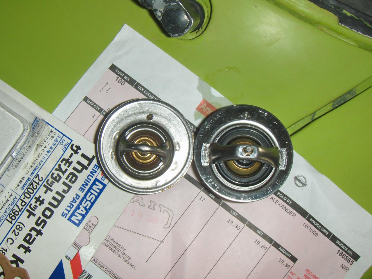

Also the orifice of some after-market thermostats is often smaller than Nissan part.
If you take a close look at these thermostats, side by side, you will probably notice that the orfice opening of the aftermarket thermostate is small than the Nissan OEM thermostat. Another good reason to buy quality Nissan parts.

Actually, my point taken is just the opposite. The aftermarket thermostat with the smaller opening, restricts volume of flow and rate of cooling done by the radiator. The Nissan OEM thermostat, with it's larger orfice, allows a larger capacity of flow and cooling. First hand knowledge!
Dan
In the photograph below, the thermostat on the left is a Stant brand after market unit. The thermostat on the right is the Nissan part for a 240Z. The difference in the size of the opening is significant.
