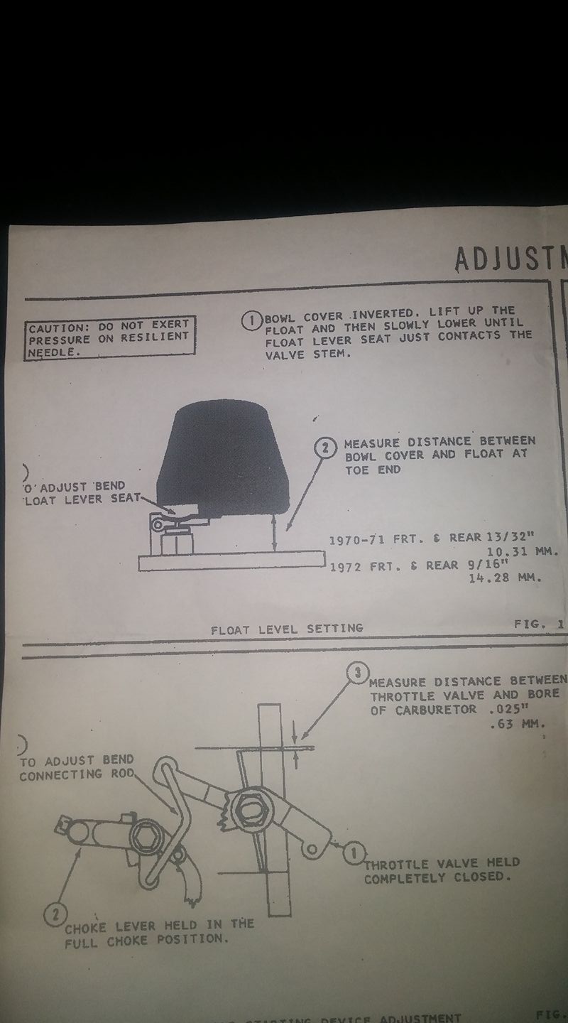

Well today was not a good day, I wanted to hook up my choke cables. I started the car and 2 minutes later the rear carb started to overflow AGAIN. I don't know what else to do. The floats are adjusted to specs, and carbs were cleaned. Is it possible that the floats should be adjusted differently. The spec I used was 14mm with the float cover inverted.
Iam going to try to set the carb to the 70/71 S.U specs.
Edited by dat260
The newer needle valves cannot be set upside down. I learned working on that the hard way. Hold them the correct way as installed and blow through the inlet pushing up on the float until your breathe is stopped. Or set up a jar thats about the same circumference as the float bowls and make a mark on the glass. I'm using my phone now and can't provide pics, sorry. I will in the morning though.
Google "setting floats 240z classiczcars.com" or "float bowl lids 240z classiczcars.com".
Edited by siteunseen
Suggest running hoses from the vents on the lids to some containers so gas will go there if it overflows.  Make sure it's not overflowing before the test drive. I run the vent hoses to a couple of empty plastic Shiracha bottles lodged under the master cylinder. I leave them there so I'll know if they ever overflow.
The rubber tip of the needle valve needs to come to a sharp point or it might not seal. If it's rounded get a new one. While it's out maybe give a blast of carb cleaner out through the banjo bolt, in case there's gunk in there. Also If the float isn't sitting just right in the bowl, especially if the fuel level is set too high, or if the float is tilted up, it can stick against the side of the bowl causing overflow.
Thanks guys, I will tackle this issue my next day off. I found out my carbs are from 70/71 series. The float specs are different for those years.
Stanley, my needle valve does not have a rubber tip and the tip is rounded. I also cleaned them last time they were out, needles and banjo fitting, they were dirty. The problem Iam facing now is that Iam running out of bowl gaskets. Everytime I open the lid the gaskets warps. It took two weeks to get them from ztherapy. Can I install the lids without gaskets?
Here's what I did.  Hope something here may help. :)
I don't understand that, maybe someone else does. I meant the end that goes into the banjo, not the part that contacts the float. There was a different type that was used for a while, I haven't seen one though.
