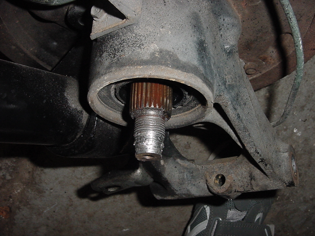

So I'm having the mechanic install new bearings while I wait for better weather, and today I get a call from his boss to come over to look t a problem with the axle.
When I got there, he explain the guy was turning the stub axle nut off, and stripped off most of the threads.
I asked why he didn't consult the documents I provided, and he said there was no need, the tech used a punch to loosen up the peened area of the nut. The FSM says to "remove the wheel bearing lock nut." the Atlantic Z writeup says you should use a mototool/Dremel with a small cutoff wheel to cut off the outer, peened ring
That obviously didn't work, because the tech guy just turned the nut off and stripped off most of the threads. See photo.
Si now the shop manager wants ME to buy two new stub axles (at $300 each, -IF- you find one) and new nuts so the tech can do the other side too.
Do you think the shop is at fault? Maybe they should accept some responsibility and do the job for free or something?
Here's a photo of what it looks like. Maybe it can still be used? the Atlantic Z writeup says you can use a ZX nut which has a plastic lock ring in it in stead of peening it down. That sounds better to me.
thxZ

The part of the axle that strips is the part where the peen is, not where the nut is really holding on. I stripped one (though not that bad), dressed the threads with a thread file, and reused it successfully. You'll have to make your own decision about how much it bothers you.
I would not let them touch the other side. That is a hack job. They could of just cut the nut off which I've done many times to keep from damaging threads. I'd understand a little thread tear but as soon as the started to damage the threads he should have stopped and used a different wrought. If I was you and he thinks he will do it the same on the other, get the car out of their and go somewhere better. Don't tick him off you need the wheel put back together correctly but don't let them damage the car. That was amateur work.

Worst Case (until you find a replacement Stub Axle): You could use the old nut on the stub. Properly torqued, it shouldn't come off -you could even spot weld to lock the nut to the axle (since it is shot already) -just be sure to use your old nut.
