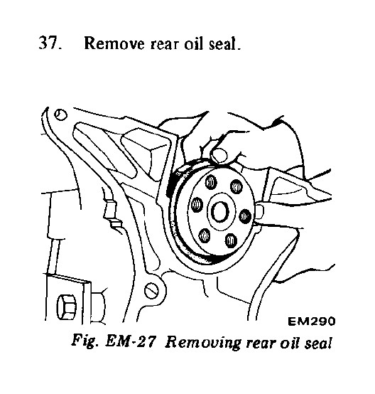

also, i got the tranny out. then saw the rear main seal, and i was able to grab it with my fingers and pull it out. there was no play but it wasn't a tight fit either! is this usual?
also, there was no groove, so i plan to just lube and reassemble tomorrow.
second note, looks like someone used teflon tape on my head bolts!!!! i plan to clean off some of the tape i can get to from the top, but its nothing big to worry about right?
Just saw this in the FSM by coincidence.
