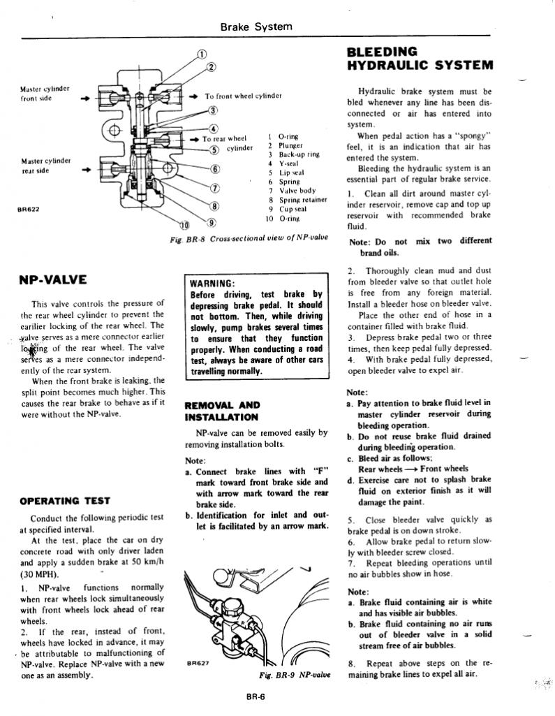

  • Remove and clean out the Proportioning Valve.
The last one is almost always overlooked. Most of us know that it is there, but few have removed it and cleaned it out. You will be absolutely amazed at what comes out of it. More than likely the Plunger is seized up with years of crud. I urge you to take the time to clean it out. If you choose to accept this task, be gentle with the flared fittings -they are soft like the others on the MC. I am attaching a .pdf for your viewing/rebuilding pleasure:).
