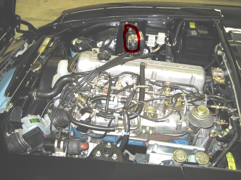

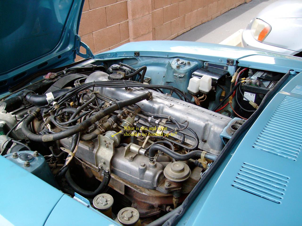

That is the 'fast idle actuator'. It draws vacuum from the F.I.C.D. magnet valve which appears to be missing on your car. Has your AC, or at least parts of the system, been removed? (Thanks to JeffG78 for the pic)

When I bought the car the AC didn't work so I chose to remove it. That part or parts (hose and all) were not on the car when I bought it. I believe the previous owner removed it when it broke and didn't bother to replace it. Without the rest of that system is that part pretty much useless? Does it affect the cars vac at all?
