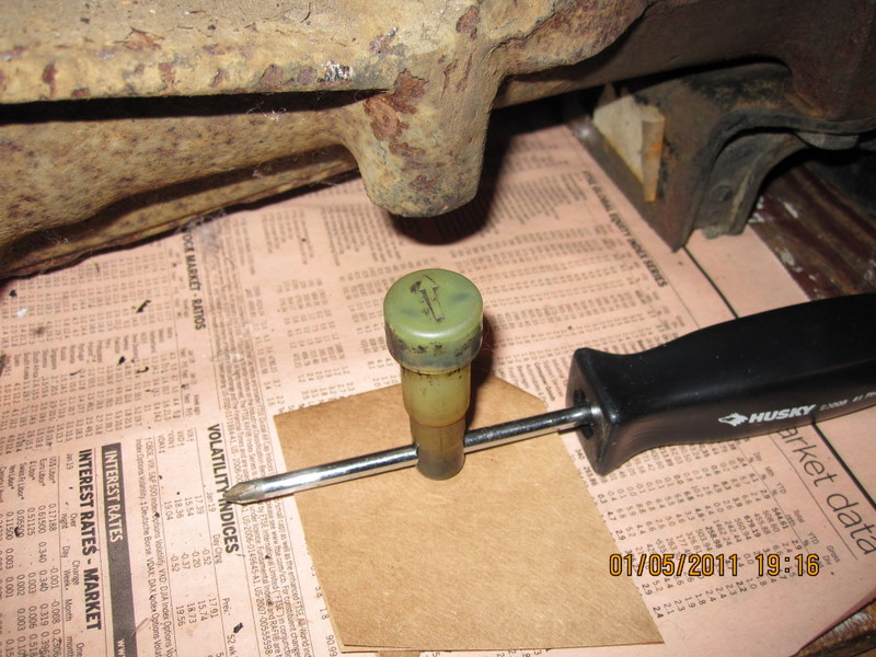

Here is a picture of the breather vent from a 1976 R200. The screwdriver goes through the hole at the bottom. The stepped down portion is a press fit in to the breather hole.
Same effect, arrow pointing forward or backward. In general, I have found that arrows are usually meant to point forward.
There has to be some "breather vent install instructions" out there somewhere!
p.s. I crawled under my car and found that the arrow on that breather points sideways as noted above. I forgot to look at the one in this picture (it's a spare), I pried it out then noticed the arrow.
Bonus finding though - my fill plug could be tightened an extra turn and might have been contributing to the oily mess.

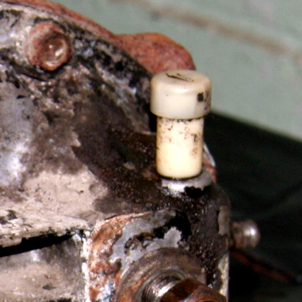

Edit - amusing coincidence - here's a 71 R180 with the arrow pointing forward, post #9 pictures (you might have to view it and blow it up to see it) - http://www.classiczcars.com/forums/showthread.php?threadid=40824
