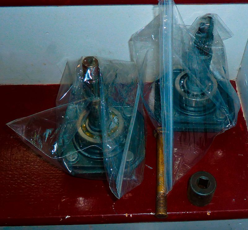

July 24, 201114 yr comment_362292 Hit the parts car and removed a lot of hardware.Picked up remaining hydraulic hose for the gas tank evap lines.Installed spindle pin and assembled strut housing to rear control arms. A file and a scissor jack were my helpers.Cleaned up a lot of over spray powder coating on rear hub races with my good friend Mr. Xacto and Mr. Scotchbrite.Assembled nice powder-coated rear dust shields with new brake cylinders. It is nice to work with not rusty, non-dirty, non-oily parts. I even chased all holes last month so everything went together quite well.Installed rear wheel studs and oil shields into hubs. Now they are in the freezer waiting to have boiled bearings pressed in in the morning.My goal is rear wheels, differential and gas tank in tomorrow then the engine reassembly starts. Link to comment https://www.classiczcars.com/forums/topic/38099-2011-what-did-you-do-towith-your-s30-today/?&page=15#findComment-362292 Share on other sites More sharing options...
July 25, 201114 yr comment_362462 Boiled bearings and frozen hubs for breakfast. Link to comment https://www.classiczcars.com/forums/topic/38099-2011-what-did-you-do-towith-your-s30-today/?&page=15#findComment-362462 Share on other sites More sharing options...
July 25, 201114 yr comment_362463 Link to comment https://www.classiczcars.com/forums/topic/38099-2011-what-did-you-do-towith-your-s30-today/?&page=15#findComment-362463 Share on other sites More sharing options...

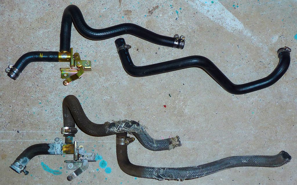

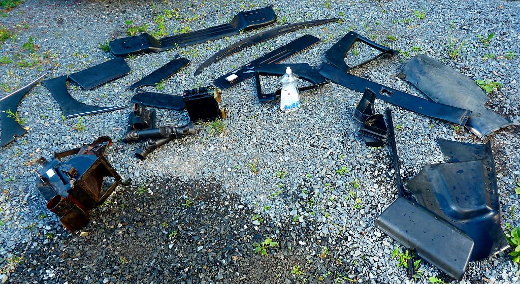

July 28, 201114 yr comment_362644 Painted and Insulated Heater housing. Installed new hoses and valves Completed rear brake drum/shoe install (hunted missing parts from hundreds of baggies... ohh car restorations with every bolt off!) Fitted gas hoses to tank Sourced and cut rubber for attaching to tank straps chased all holes near front where bumper, grill light buckets go rebuilt/refreshed brake pressure loss switch installed cowl clip rubbers installed pedal rubbers installed master brake cylinder and chased the painted studs removing 40 year old ziebart from headlight assemblies Link to comment https://www.classiczcars.com/forums/topic/38099-2011-what-did-you-do-towith-your-s30-today/?&page=15#findComment-362644 Share on other sites More sharing options...
July 29, 201114 yr comment_362738 Installed rear brake hosesInstalled gas filler surround and rubber flap Painted transmissionPainted interior partsPrimed front grill, rear licence plate holder and two tail light surroundsrefreshed SU carb one more to go Edited July 29, 201114 yr by Blue Link to comment https://www.classiczcars.com/forums/topic/38099-2011-what-did-you-do-towith-your-s30-today/?&page=15#findComment-362738 Share on other sites More sharing options...

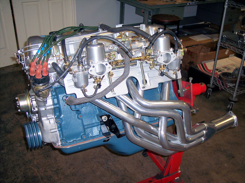

August 6, 201113 yr comment_363379 I finished "dressing" my engine in preparation for the upcoming install. Now to get it off the stand and onto blocks for the flywheel and new clutch kit, then to get the tranny bolted up. Fresh carbs are by our good friends at Z Therapy. Thanks Bruce! Jim Link to comment https://www.classiczcars.com/forums/topic/38099-2011-what-did-you-do-towith-your-s30-today/?&page=15#findComment-363379 Share on other sites More sharing options...
