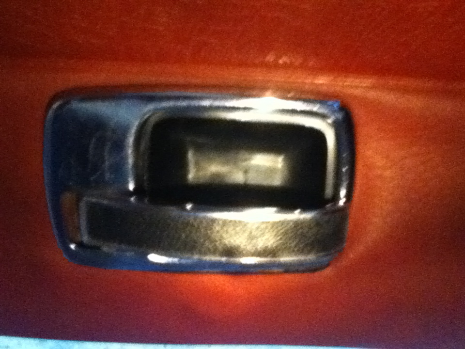

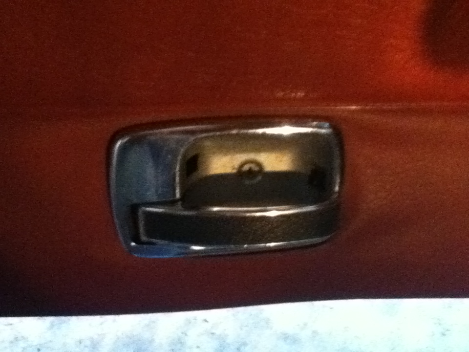

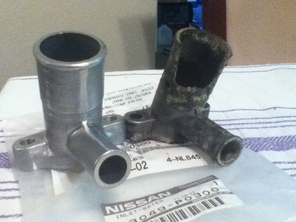

Today: Hardest part I have replaced on the Z... LOL

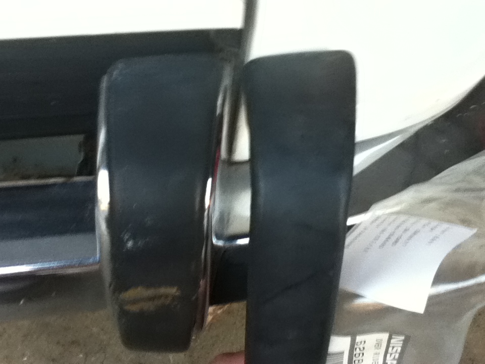

Tomorrow (hopefully):
I got both bumper guard rubber pieces, the other one is not damaged, but will be replaced anyway.

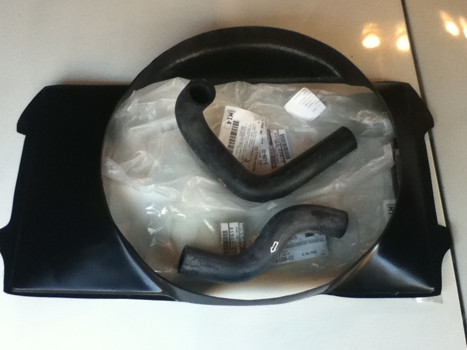

Aside from getting a new fan clutch and flushing the hell out of the radiator, hopefully these will help my Z run cooler :cool:
[ATTACH=CONFIG]46283[/ATTACH]
Have you considered a Cooling agent in the radiator? Red Line makes a product called "Water Wetter". look into it.
Zs-ondabrain: I actually did put water wetter when I first got the Z... but I have never taken the radiator out to flush it and I think I should have it boiled/rodded and pressure tested. My priorities are screwed up I suppose. I also need to fix the dash/side/parking light problem. I read an old thread on how you said to test for it, but the other member had a 280z... I don't suppose it is much different. Thanks for your help and suggestions Dave!
It's basically the same for most S30's. I don't know what's wrong with your Parking light circuit but if they don't work, check the fuse (3rd fuse down on the right) with and actual test light. Also test the green/white and green/blue wires at the combo switch. If you have power at the switch, flip the switch to the first click and see if there is output on the other wire..

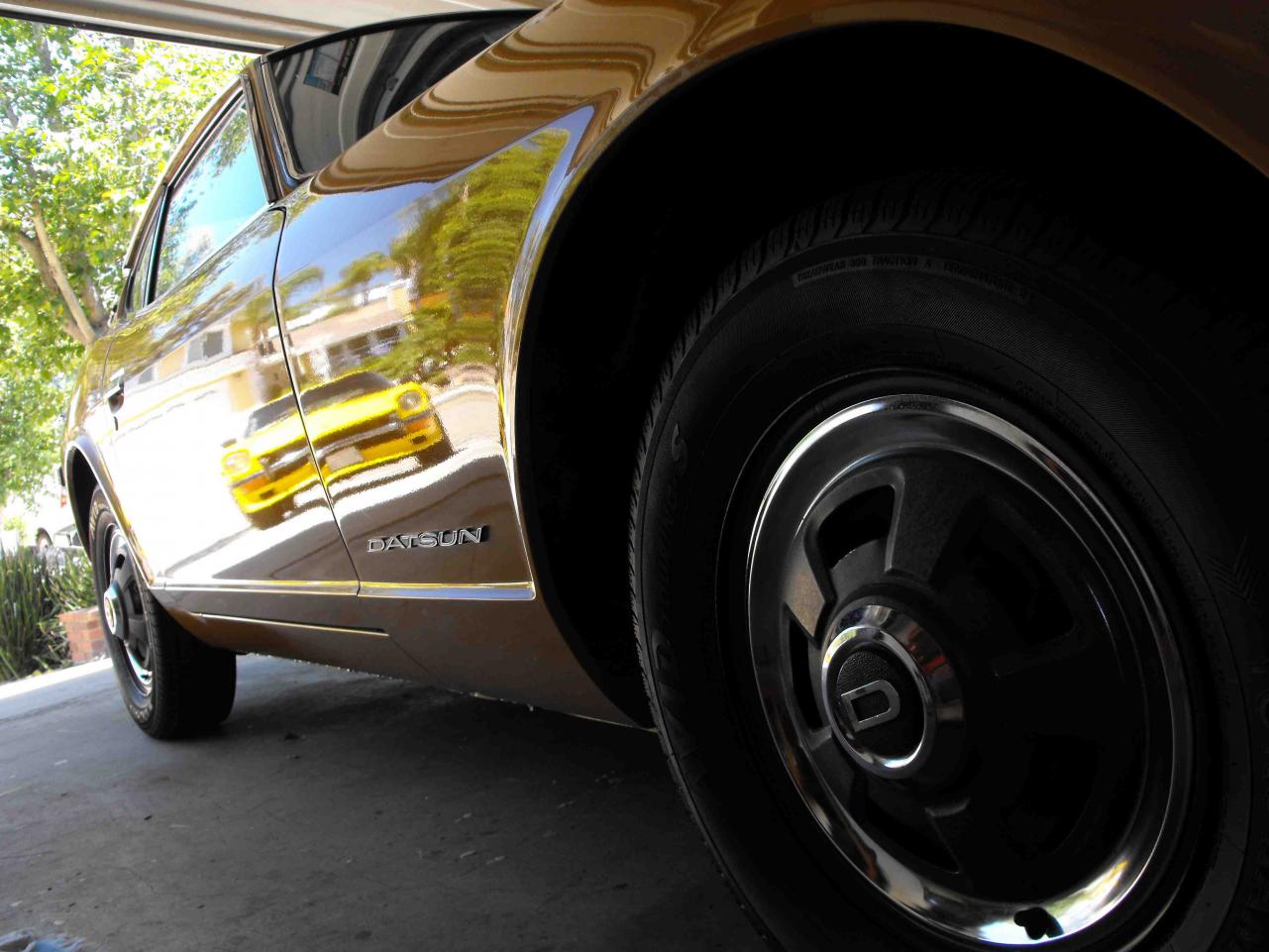

Since the gas prices have dropped I decided to fire the old gal up for a drink of BP high test. So, when came out of the store a lady was out my Z. She said, we have one of those. Her husband spoke up and said, no dear we have a 81Zx. I gave her a TZC card. So when I arrived back home,I wiped her down. She is currently taking a nap.

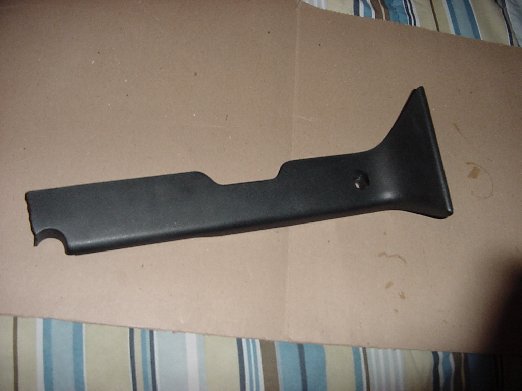

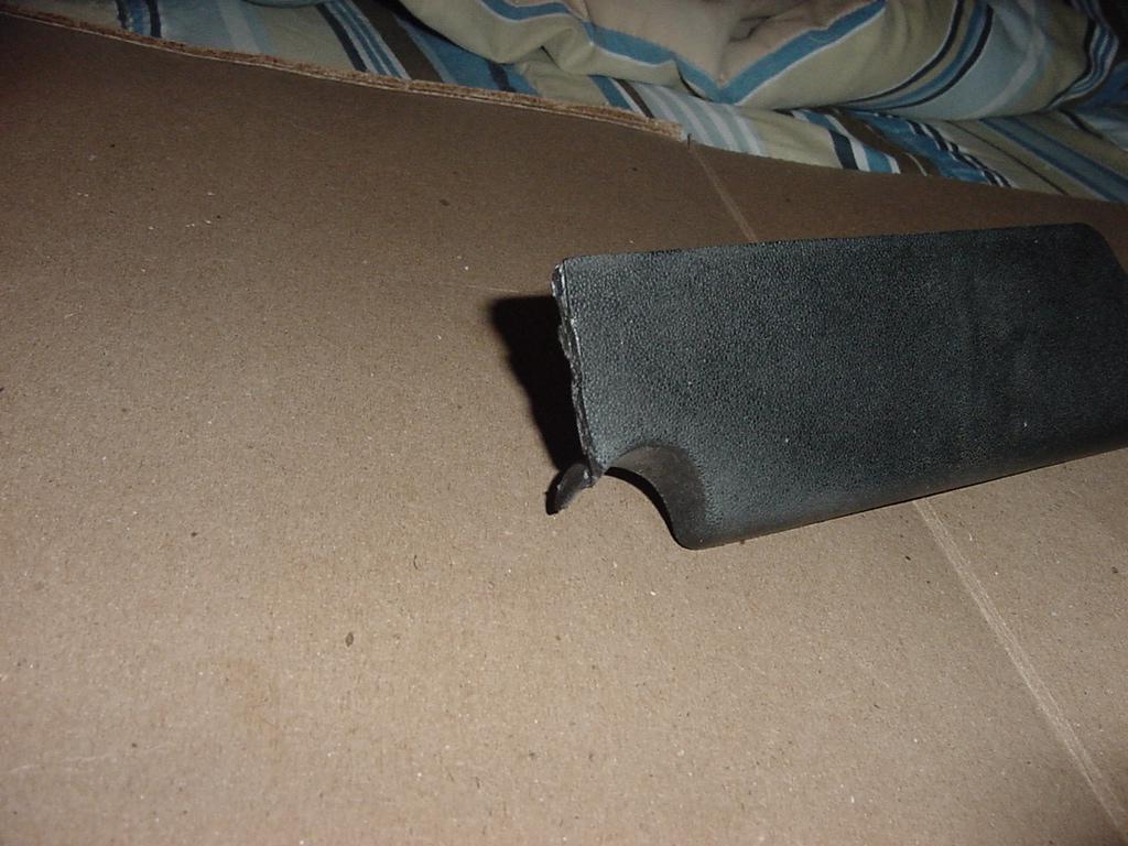

I am currently trying to repair a couple interior pieces, and make a new one. The two I'm repairing are the left lower dash cover and the right foot well harness cover. the foot well cover is getting so,me aluminum angle reinforcement, and should be done.
The lower dash cover has the end broken off, by the hood handle, so I can't see where it attaches, and I would like to ask if anyone has a good closeup photo of that end, or just the entire part. Attached are two photos of the broken end, and the lower dash cover itself.
The part I would like to make is a nice plastic cover for the right side, where the fusebox is on a 280Z. There is an unsightly fiberboard panel there and I would rather see a nicer cover, like the one on the left side, that covers ECU.
