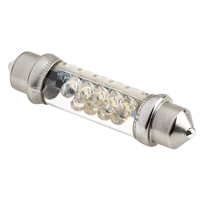

August 11, 20159 yr comment_475484 I just installed a 4-chip LED festoon bulb in the '97 and that darned thing just lights up the whole cabin! Granted, the clear plastic cover lets all that light get around the cabin, but it's better than the old filament bulb, although I may look for the same thing in warm white some time. Â Link to comment https://www.classiczcars.com/forums/topic/37915-sold-on-leds/?&page=6#findComment-475484 Share on other sites More sharing options...

October 17, 20159 yr comment_479268 What about those Can-Bus LEDs? Can we use those for the Zed? I was considering using a dome lamp bulb that had some CREE LED chips on it, and it should light things up well. 9W LED Festoon Dome Light Car Bulb 3x Cree SMD 3021 3022 DE3175 White Link to comment https://www.classiczcars.com/forums/topic/37915-sold-on-leds/?&page=6#findComment-479268 Share on other sites More sharing options...
