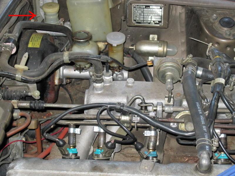

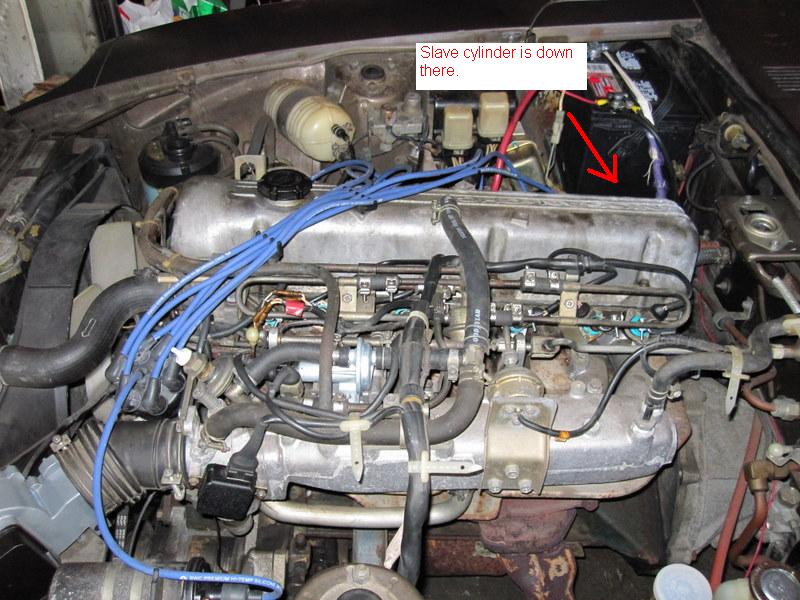

Clutch and slave cylinders are good novice projects. Your master cylinder and reservoir are in front of the clutch pedal on the other side of the firewall. Picture with arrow attached. Your slave cylinder is bolted to the side of the transmission on the passenger side. If you look down between the battery and the starter (second picture), and back to the transmission you can see it from above. There is a flexible hose attached to it which holds the hydraulic fluid. Brake fluid is the hydraulic fluid used to fill the reservoir.
This is an EFI engine so will look different than yours but the parts are in the same general spot on all Zs.
Careful with the brake fluid, it will eat your paint if you spill any.
