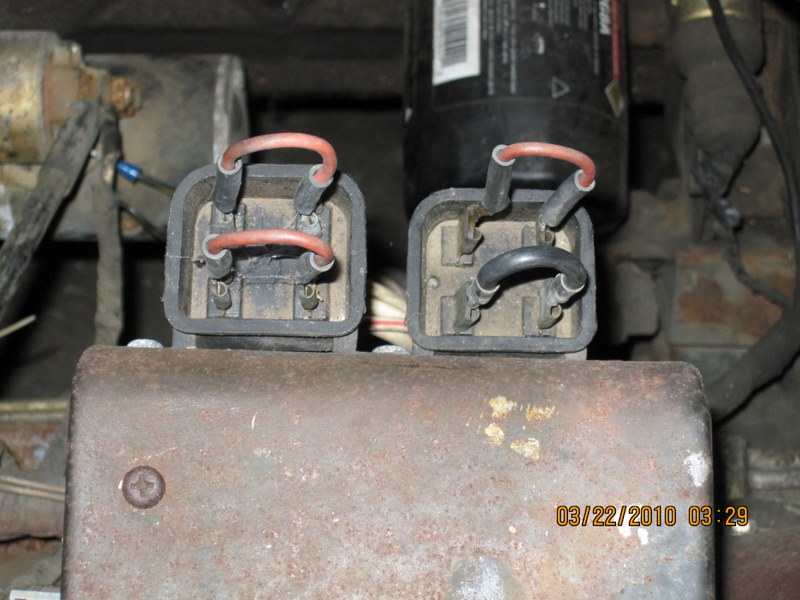

My fusible links do not look like they look in my manual. They look like they have been crimped together with one of those Plastic covered copper sleeves. Also electrical tape on the wires. If these even are the fusible links. But i didn't find anything else in that area that could be what i saw in my hanes. I'll post a picture of them.

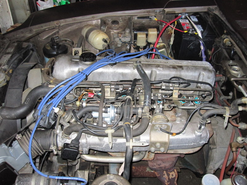

It looks like someone removed your fusible links and mounting fixture entirely. Here are a picture of fusible links from a 76 and 78. The 76 is the full engine shot. The 78 is the closeup from the top. Your 77 should look very similar. The red/white wires in your picture probably used to run up to the bottom of the fusible link fixture. The links are under the two white plastic covers in the full engine bay shot.
You should probably re-protect those wires while you're finding and fixing your short.
