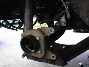

where does the bracket pictured below (and taken from the article you linked me to) come from? is that the maxima bracket you are talking about? what years should I be looking at? it just slides onto my rear stub axle?
the '82 Z I got the calipers off of had its caliper bracket as an integral part of the lower A arm it looked like - that's why I didn't grab it...

I recently bought a set of brackets shown in the link above. They are Nissan parts and from what I understand they are made specifically to fit ZX calipers from a 280ZX to a 240Z. I may be mistaken but that's how I understood it. I don't know what year caliper they're for still looking for that info. You may be able to find those brackets somewhere otherwise good luck trying a bracket from another car. If I remember I'll get the part numbers on the package - they're still in the original Nissan bag/box.

When I ordered mine, I spoke with Rodger. They are off a 1980 sedan -- not a Z car. He knows me since I've ordered quite a bit from him so mention they are the same parts that Rick Hanson from St. Louis ordered about eight months ago.
