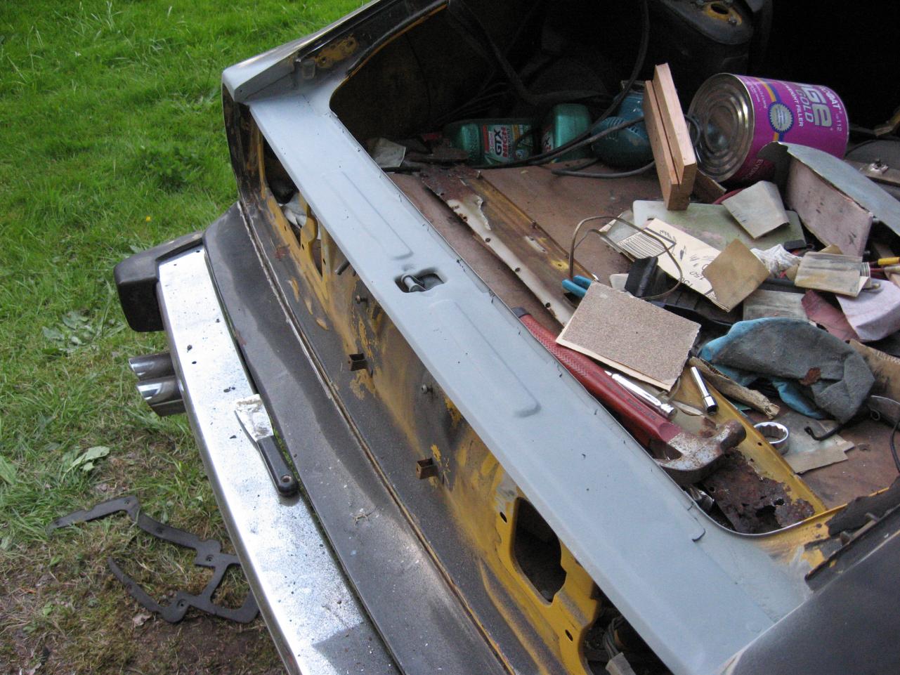

I have a '72 and am in the process of replacing some rusted metal. I have read of the possibilty of bonding the under-hatch (above tail lights) repair panel using one of the high-tec body adhesives. Has anyone done this? I thought about using this method along with spot welds on the braces coming off the rear panel above the tag. Seems like this would eliminate the possibility of rust after welding in hard to treat areas. Any thoughts? Does anyone have one of these panels made by Nissan they would like to sell? Thanks!

I spot welded mine on and used seam filler on the underside farely strait forword.
Nice job on the fix! Did you use any special coating on the original metal under the panel you welded in place? Looks like that rust went fairly deep into the rear structure..

Looks good grantf...does it seem like the seam sealer will keep the water out from under the panel (above the tail light panel)? That's the area that always rusts and after welding, it doesn't look like there's a way to seal it off well enough to prevent future rust.
CoastGuardZ, you do remove the old part first...I didn't mean to imply that you bond on top of the original part...it has to come out first. But, there's some good sized overlap areas when installing this part that would allow you to bond it in and not have to worry about untreated areas.
