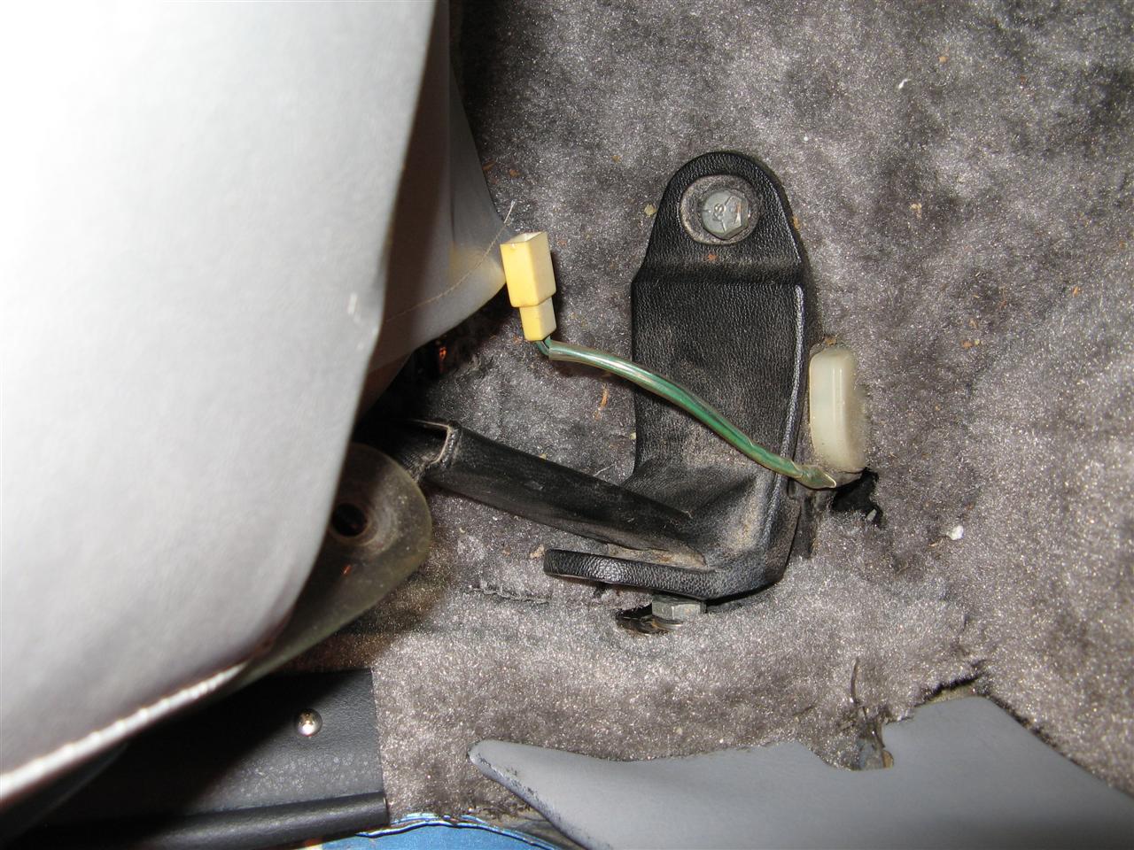

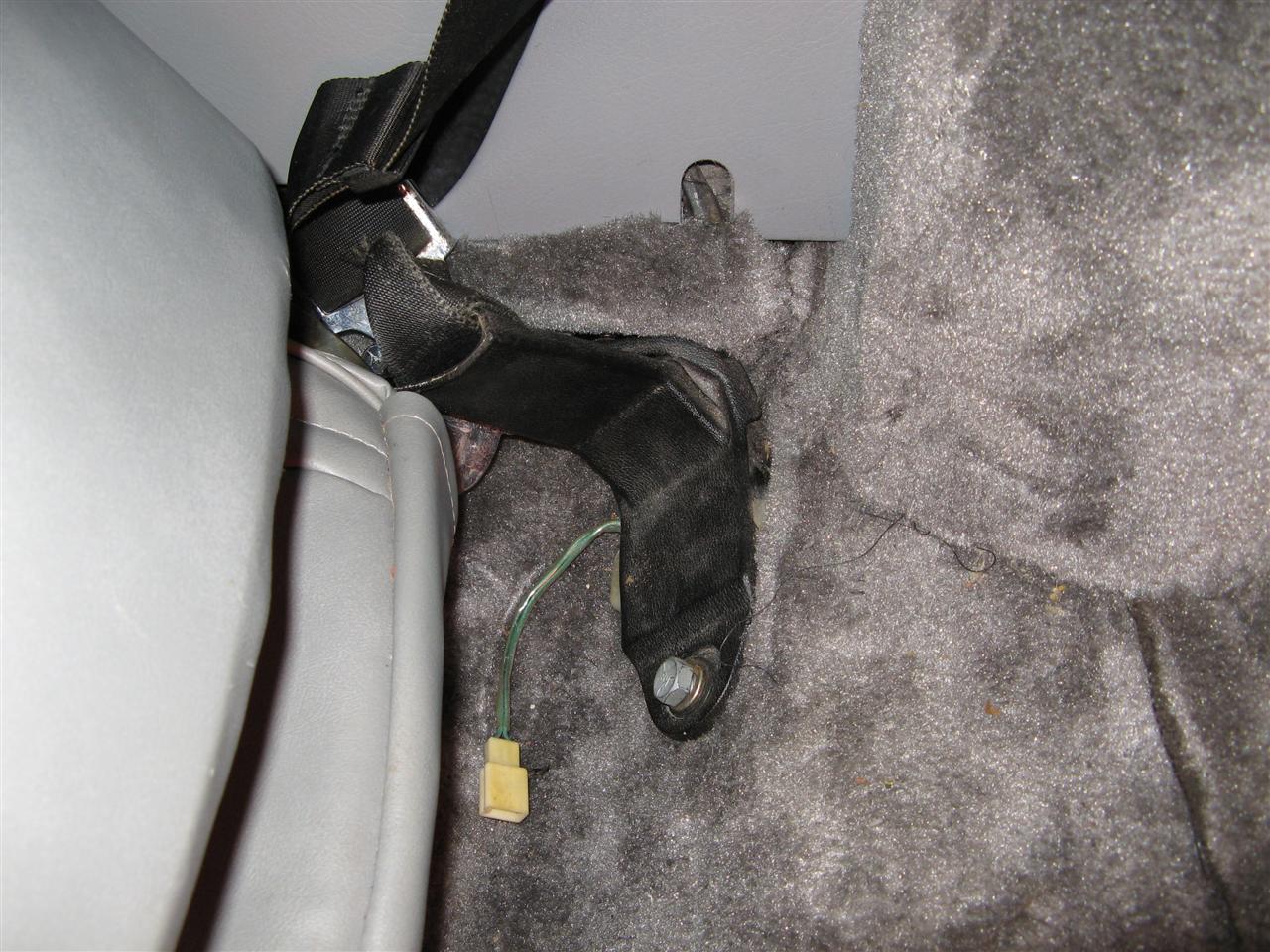

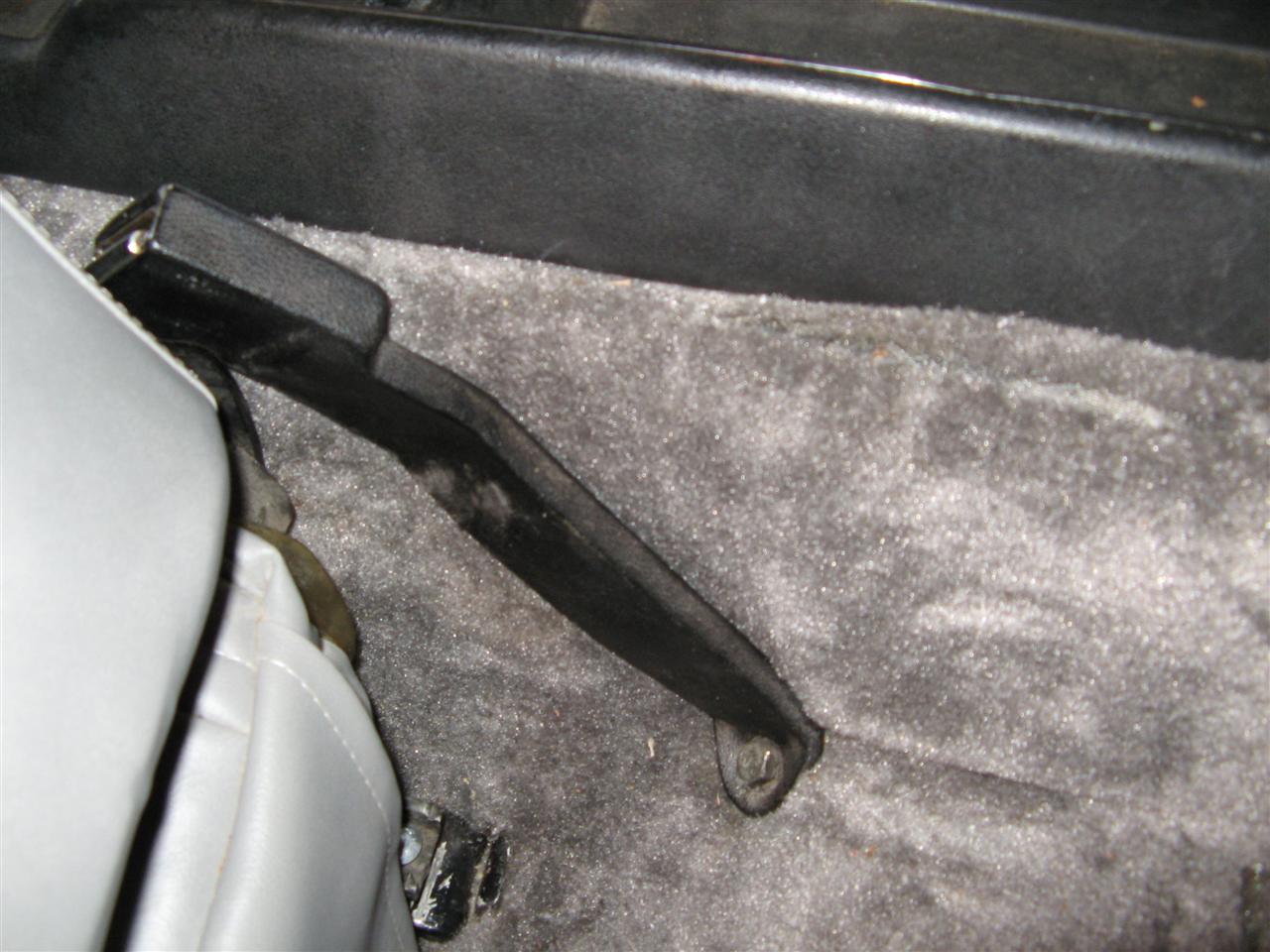

Ok, here are some pictures. I'm not sure if they are helpful. First of all, my interior is non-standard as you can tell by the gray carpets, seatcovers, and vinyl.
The first picture has the driver seat slid all the way forward and tilted forward looking straight down on the retractor mechanism. You can see the outboard bolt under the retractor cover near the bottom of the picture. As I recall this bolt location is used by the non-retracting belts. Near the top of the picture is the extra bolt that you should have a plugged hole for in your pockets.
The second picture shows the driver side inside seatbelt buckle mechanism. Compared to the original lapbelt-only design this uses a stiff assembly that mostly stays in place. I believe this is required for a switch and the wiring that you see exposed in the picture - the dreaded seatbelt buzzer. Note that my wiring is not even hooked up - I don't know if I even have the required wires available.
The third picture is across to the passenger side retractor mechanism. Note that the shoulder belt does not retract. I just goes along for the ride when the lap belt retracts and extends. I believe later models had a retraction mechanism for the shoulder belt mounted near the roof pillar.

not sure if i'm looking at this right- but how come the driver side looks to be mounted vertical and the passenger side is mounted horizontal? shouldn't they both be mounted horizontal only mirrored?
know what i mean?

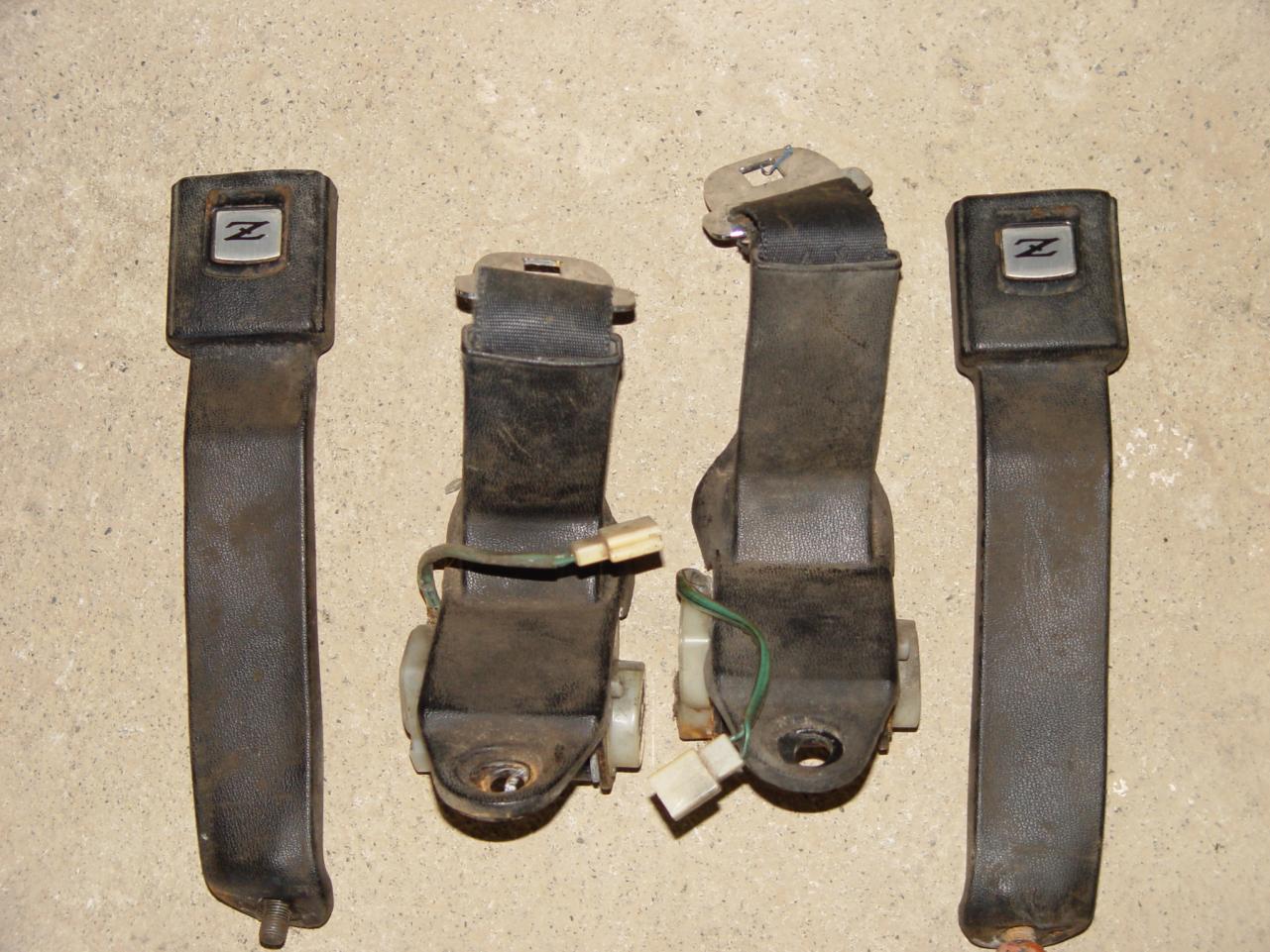

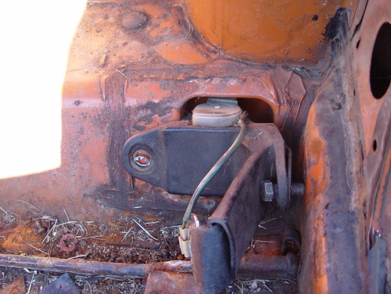

Here are some shots without carpet or seats, and the belt mechanisms separate. (from my parts car). The pics are of the drivers side.
The pics of the receiving end are well represented in MikeW's post.
The only thing I had that I don't see is the nylon strap that goes under the center console, and holds the two center receivers.
I hope this helps you out.

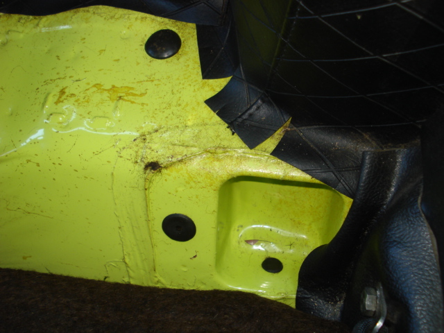

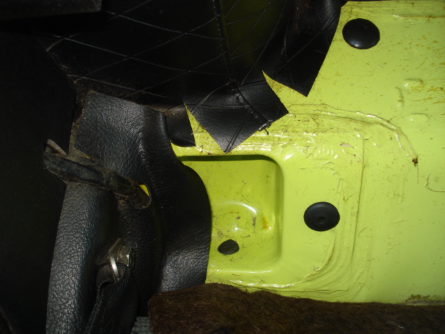

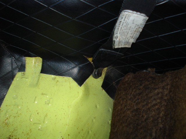

here are some pics.
what is the plug up top?
what are the wires on the passenger side?
The plug up top is just another floor drain plug. Not sure why they are up that high, but they are on my 72 also. Just leave that plug in place. The one to the side of the pocket is for the bolt that mounts the retractors.
Are you talking about the wires under the passenger side interior dog leg panel? That is just part of the rear wiring harness that runs back through the body (for taillights, antenna, defroster, etc.).
