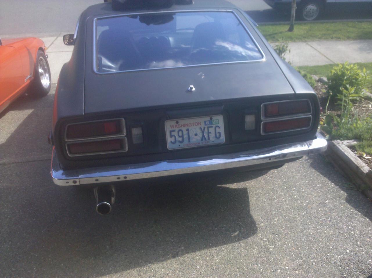

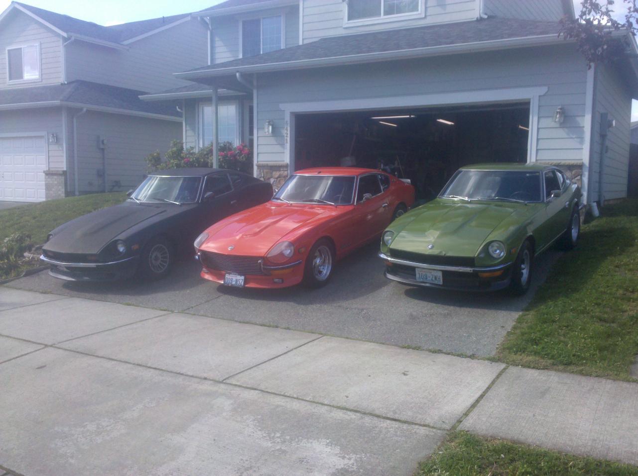

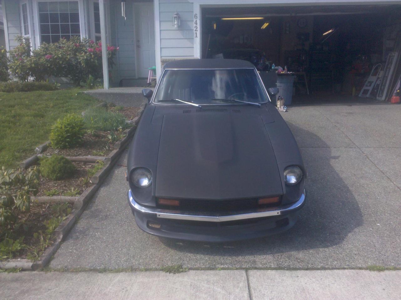

I attached a few pictures of the finished product and a comparison picture next to two 240zs.

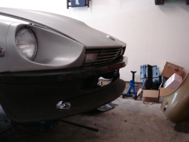

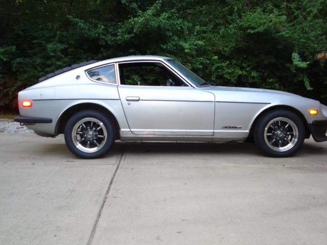

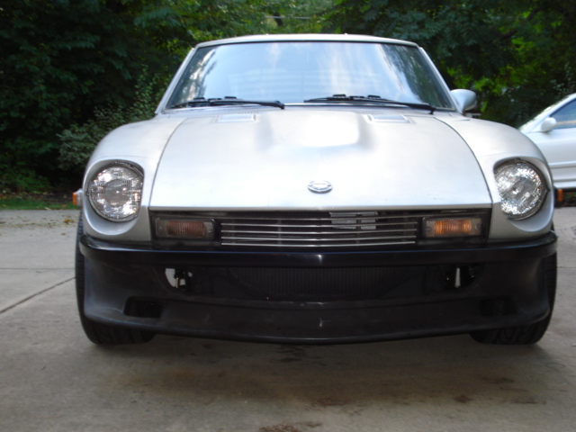

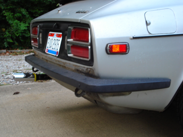

Here are a couple photos..
looks way better than that plastic thing you used to have. Where did you get the old bumpers? I would like to get rid of the park benches some day but they are hard to find and pricey.
