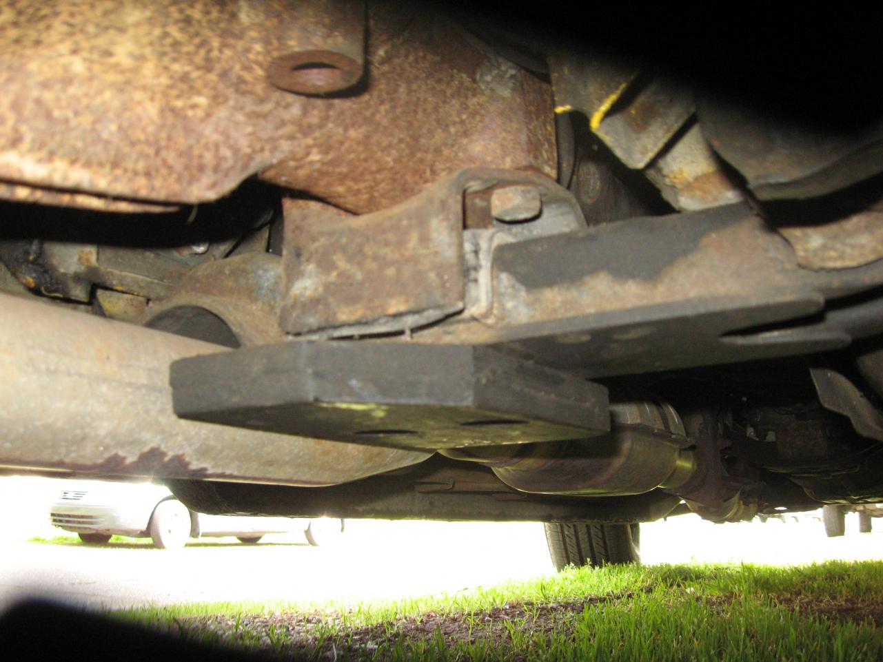

I know there are many a post regarding this topic but I am still a bit confused. My car sufers from it and I would like to know a bit more before I star buying parts and dismanteling the car. here is a picture of where I think the problem is but I am not sure.....
I maybe wrong, but I've read that it may be the differential mount insulator... or the diff strap (esprist sells these).
??? is the pic I provided the dif mount? sort of confused with my set up compared to other poasted pics I have seen here. I have a 78 280z.
Your diff mount has failed. Nissan didn't build it with a "Failsafe" so when the rubber seperates from the metal on either side of the front diff mount, the diff lifts up and "Clunks" thediff strap or body, then also clunks on the way back down.

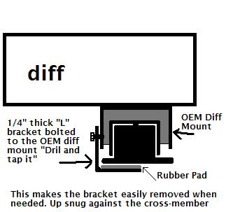

3) Bolt in a 1/4" thick L-bracket to the back side of the mount, so the other half of the "L" is face up with the bottom of the cross-member, place a rubber pad on it to keep it from Thumping the cross-member upon raising.
I've attached a drawing (my own take on it) to help you visualize #3. I've been informed that it works very well and is obviously inexpensive. You just need to drill the stock diff mount and tap it for the decent size bolts you'll use.
Use your imagination on that one, might even be a market for it if customers want to drill and tap their stock diff mounts.

already replaced all of the u-joints over a year ago, I just wanted to know if the picture posted showed any glaring signs of a mount failure.

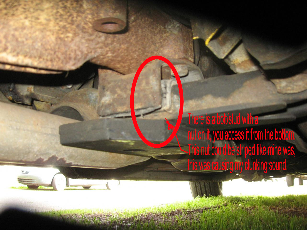

I had the same problem, I completely redid my rear suspension and found the the nut attaching the cross member to the diff mount was bad. See the picture attached. The stud is pressed into the mount, not a good design for access or strength.
A failed mount generally shows no outward signs while sitting parked and relaxed.
