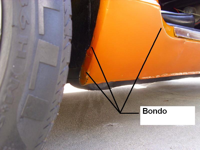

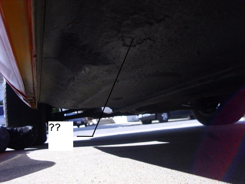

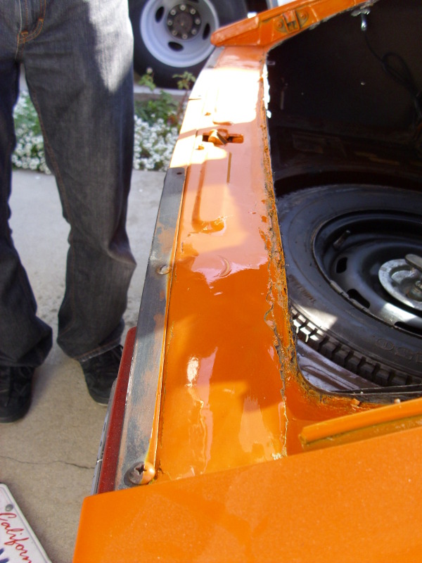

The car is probably salvageable, but $3500 is WAY too much money. It has some serious rust issues, some of which (passenger dogleg, for example) appear to have been just puttied and painted over. The previous repairs (passenger floor, right frame rail, driver's dogleg, rear valance) appear to be pretty half-a$$ed.
For $3500 in California, you should be able to buy a car with far less rust, and in better overall condition. I'd recommend some patience and that you pass on this one.
some more items. The paintjob is really lame. Very bad overspray as you noted. also, you can see the bondo or bad patch spots.
This is not a $3000 dollar car. Maybe $1600. There are much better...
sigh...ok, so it looks like a lot of what i thought was bad paint is actually putty and rust cover-up. Maybe I just wanted to believe it was better than it was. Thanks for the help yet again, guys, this thread definitely saved me a lot of headache and potentially my life if that fabricated frame rail would have gone out.

Both sugar scoops show cracks, both rockers show damage, complete rear end is one big bondo swab, interior is ... garbage. Cleanest part seemed to be the engine bay, and that has overspray.
In a nutshell, this is someone's high school auto shop class project.... and he got a C-.

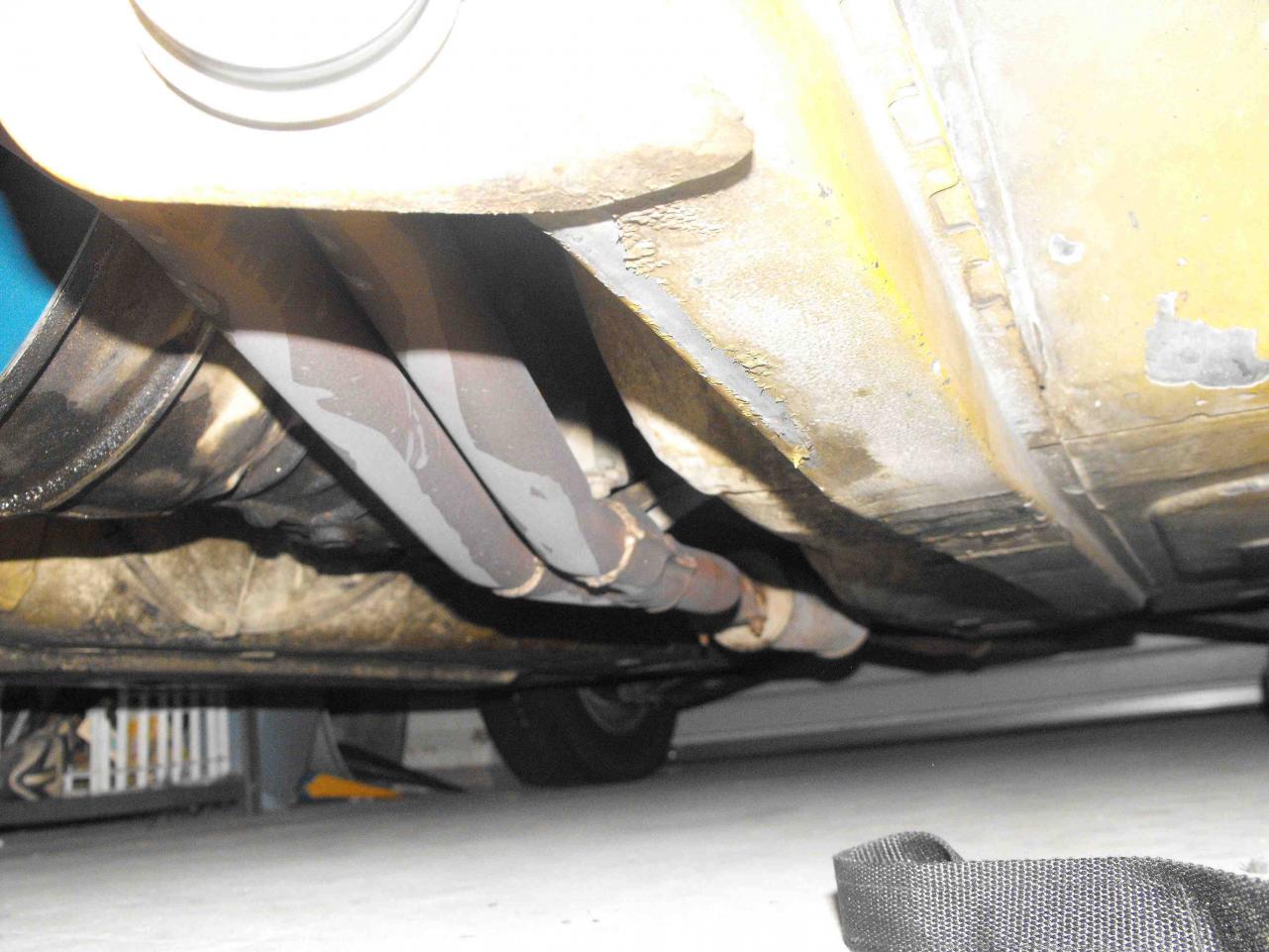

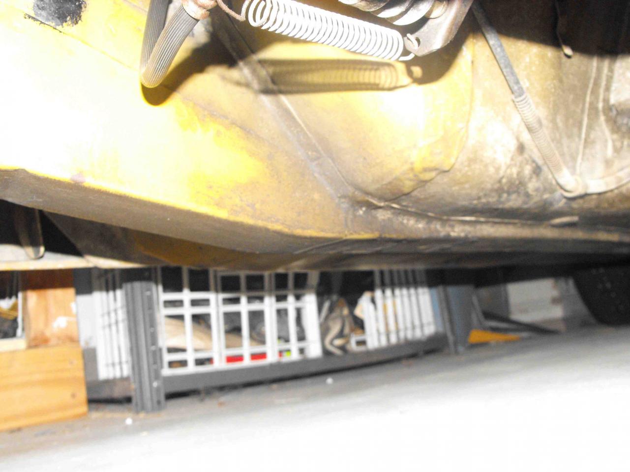

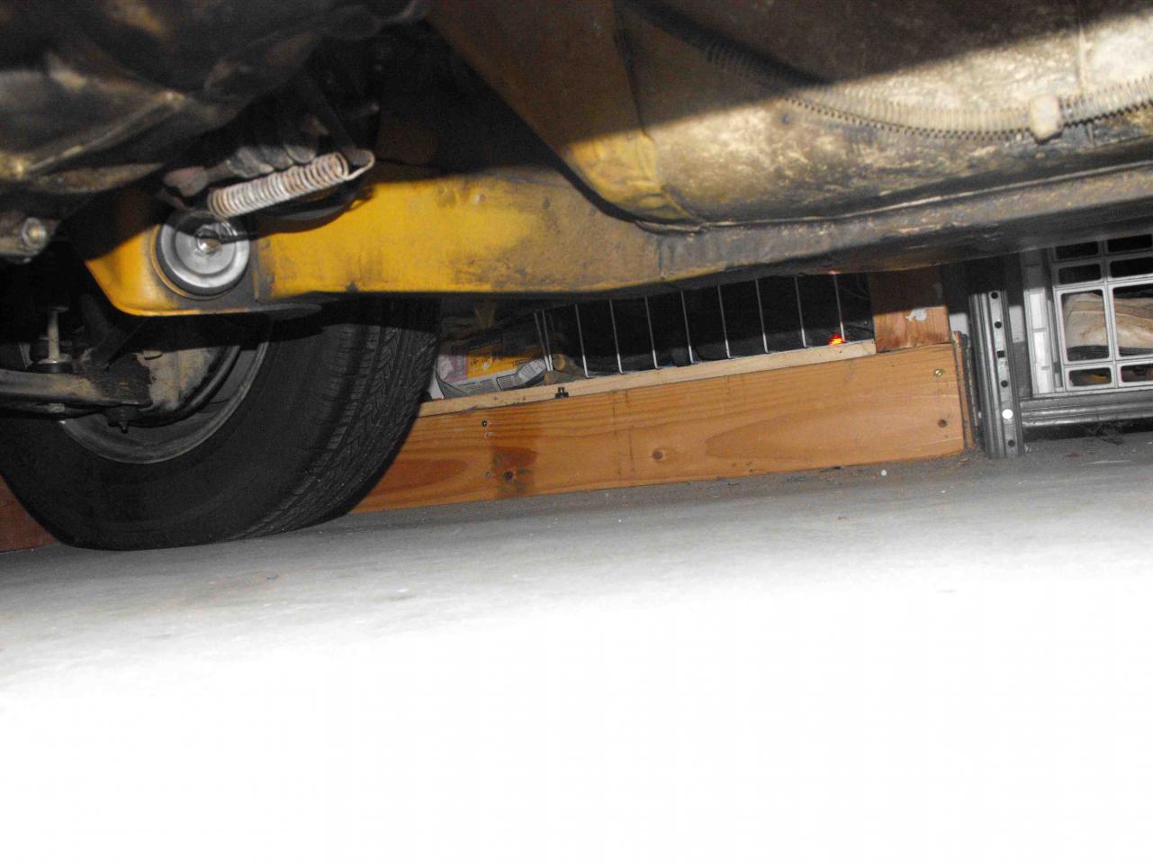

Yes, the first silver ('71 240Z) sounds like exactly what he is looking for. The guy was originally asking $4500, but took $3200.
The only rust issue was a quarter sized rust hole in the passenger floor pan and two minor rust patches near the rear dog leg. I will be welding those up soon here (before paint), but no big deal. The frame rails were dented but no rust and in reasonable shape. The battery tray was clean.
The engine is a 260Z motor with high compression pistons that had just 5K miles on it. Still had cross hatching on cylinders when I popped the head. It also has a 5 speed trans and LSD, suspension package, Konig Rewinds, racing seat and racing wheel. All in very descent shape. The interior also was very nice. The guy also tossed in some beautiful stock seats, steering wheel and other parts.
The silver paint was faded, but I will be painting that here shortly. Now that I have the '73 (with flat tops!) running well, I will put the '71 in the garage and start stripping parts, removing motor and glass, welding holes and sanding smooth. Should take me about month. I will have Lance in OC do the paint for me.
Anyway, I am very happy with the '71. It was a very good deal and better than a lot of what I am seeing out there now.
