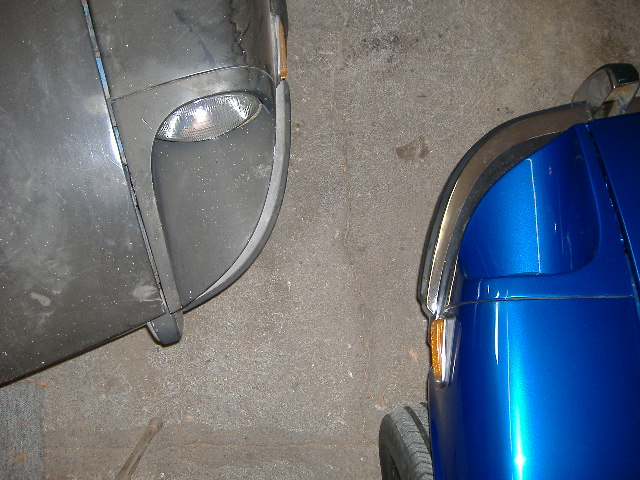

I have a pair new in the box from 1980. I doubt they will ever go on. The 73 front one will be a little different width to mount on the over-riders. Pic is of the different positions of the over-riders of series 1, (black) thin and even with the hood line. The 73's are a little wider and closer in.
Bonzi Lon
