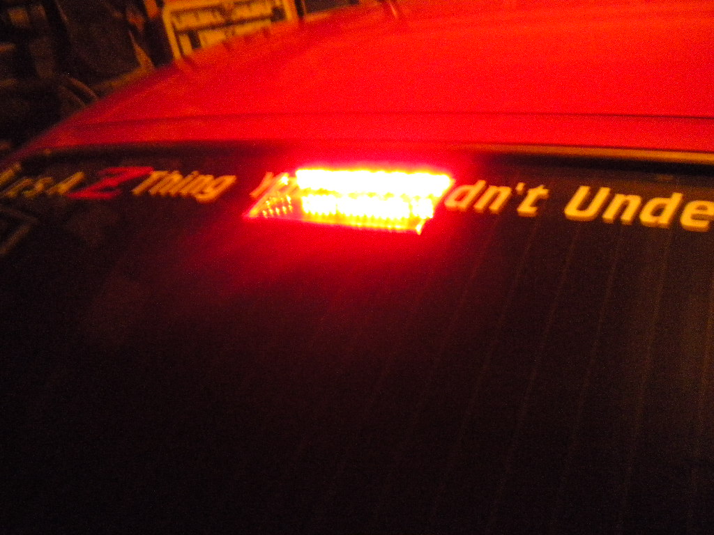

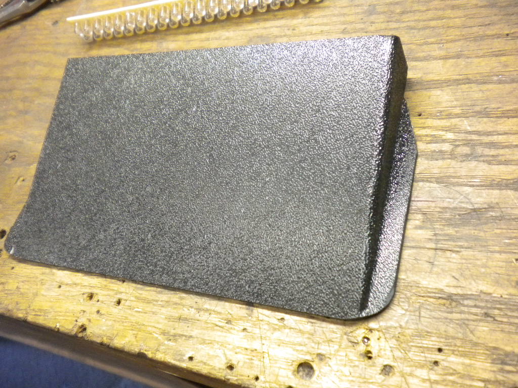

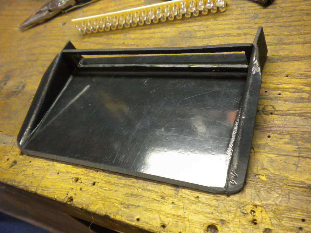

I'm working on an LED version as we speak. it's a double row of 5mm superbrite Red LED's 20 per row for a total of 40 LED's.
It'll be at the proper angle and slide under the upper rubber lip of the inside of the hatch glass.
It'll be an easy instal for later 240Z's with seperate brake and turn signals. But the earlier 240Z's, with brake and turn signals on the same wire will reguire a diode on each light, then into the 3rd brake light wire.

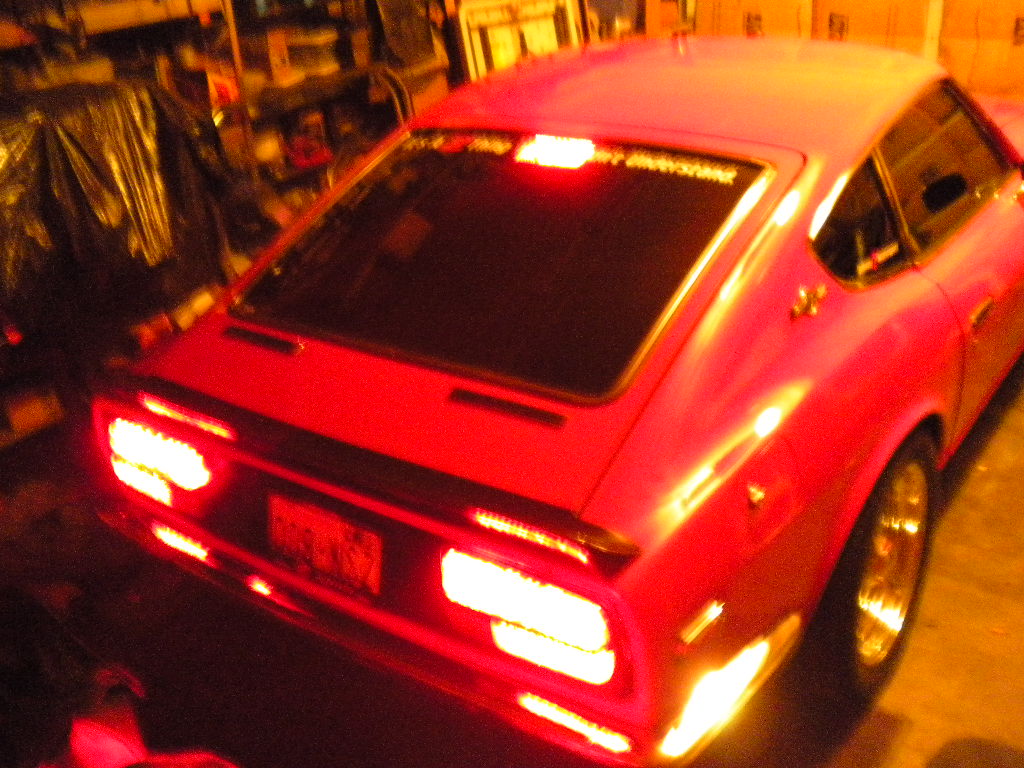

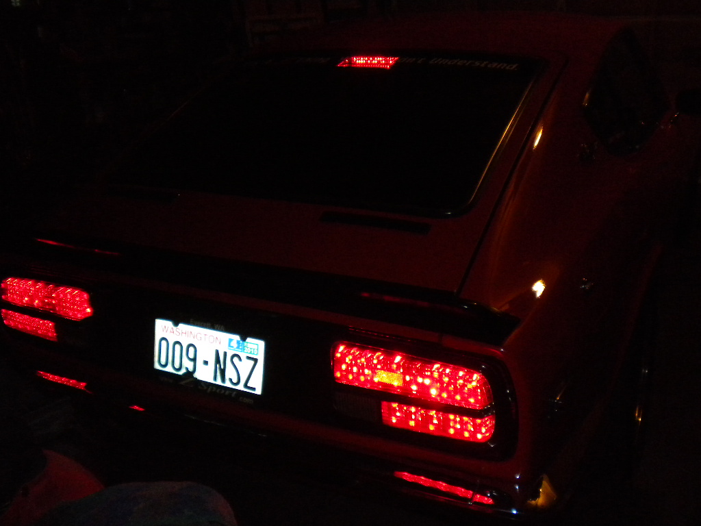

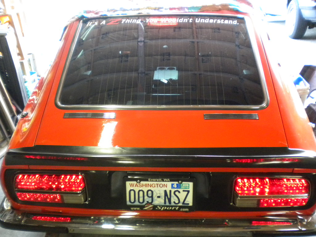

Same angle. I was thinking about making a few for $65 each. It'll come with double stick tape pre-applied, Enough wire to easily tuck into the panels, all the way down to the left brake light, 2 T-Taps for the brake and ground wire, and bullet connectors up near the light.
All you'll have to do is lay on your back, with your feet sticking out the hatch, line up the light to center and against the rubber seal, hold it there while you pull the tapes backing off and press into place. Then run the power wire to the left taillight and make the connections to the green wire on one of the top 2 bulbs and the black ground wire. Done.
