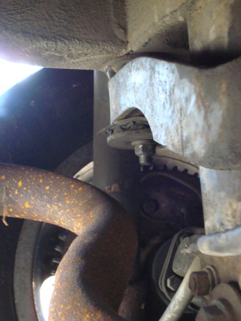

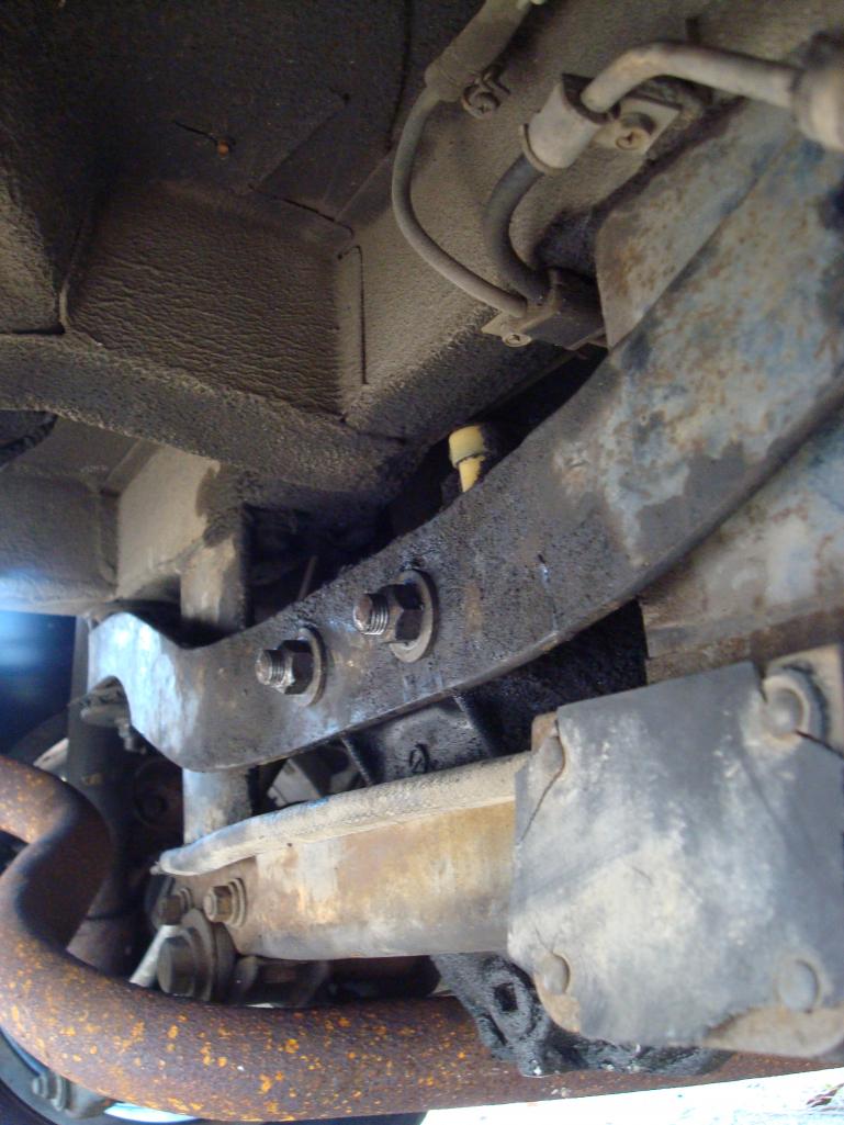

I have searched for directions on removal of the mustache bar on a '77 280z and found none. All i found are for older 240z's and my bar will not come off using those instructions. Looking at the bar, i thought it would come off easy without having to disassemble the rear suspension and exhaust :disappoin

I was able to remove all 4 nut holding the bar to the frame and diff housing. I then was able to slip the bar over the studs by raising the diff housing. This is as far as i got, the bar would hit against the suspension before clearing the studs out of the frame. No amount of prying and #@$ing did any good, even if i were able to remove it with the deteriorated bushings on the bar, when i replaced them it would be tighter. When you are by your self working on the ground in the backyard it can be a pain.

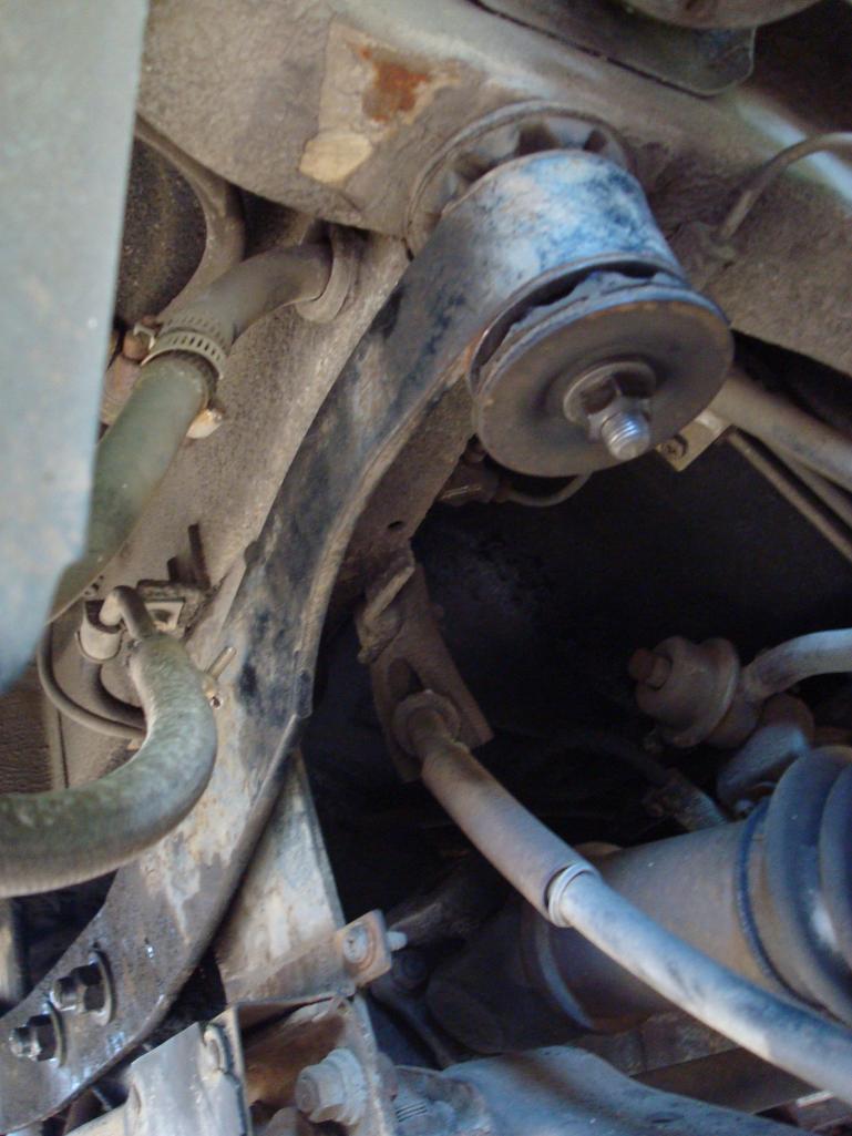

After a bunch of diff R&Rs on my LeMons 260, I can now remove a front mount in only a few minutes. It used to take me several hours to swap a front mount. The trick is body position. Lay on your back with your feet hanging straight out the back of the car and reach the opposite arm from the bolt you are working on up over the diff to remove the bolt. It's hard to describe, but it works great. To remove the passenger side front vertical bolt, reach your right hand with a 1/2" drive ratchet through the suspension and above the diff. With your left hand, hold the nut with a wrench. Repeat using the other arms for the driver's side bolt. If you try to reach the same side bolts, your arm will be too long and will be in an awkward position. Likewise, laying sideways or forwards doesn't allow any room for your arms and hands.
