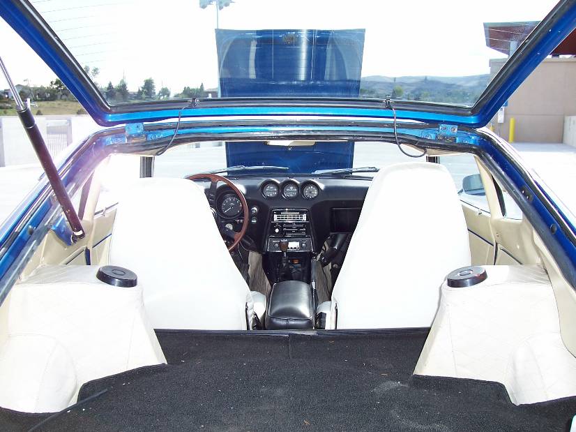

If you want them looking new try what I posted earlier. When I bought my first Z I thought I had the wrong color since it looked like a really dirty butterscotch interior, but it was white. These results took time and some over nicotine exposure, but they are all original panels. See below
