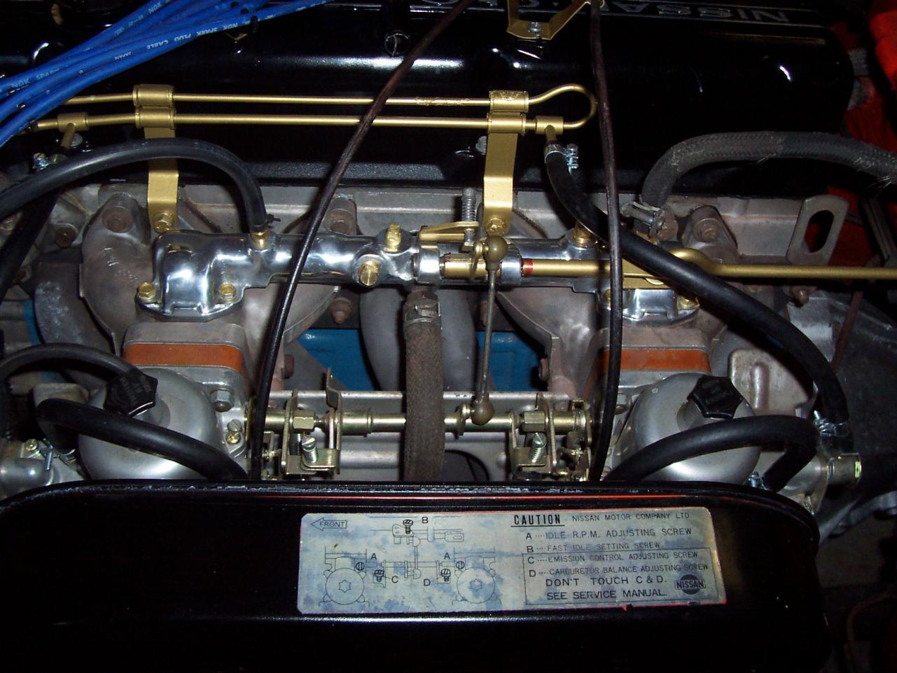

That rubber plug was covering the PCV valve. Thats no good, and it may be part of your problem. That should be routed to the tube below the distributor that comes out of the side of the block.
That balance tube should be seeing a vacuum not pressure. It connects to the tube Arne was talking about and it sucks the excess vapors out of the crank case to ensure pressure does not build up. If your getting pressure back through your intake, that means that during the compression stroke, there is a leak path back to the manifold, through an intake valve.
Could it be something simple like having the plug wires connected wrong. Which causes the plug to spark before the inlet valve is closed which in turn causes pressure buildup in the intake manifold and balance tube?
