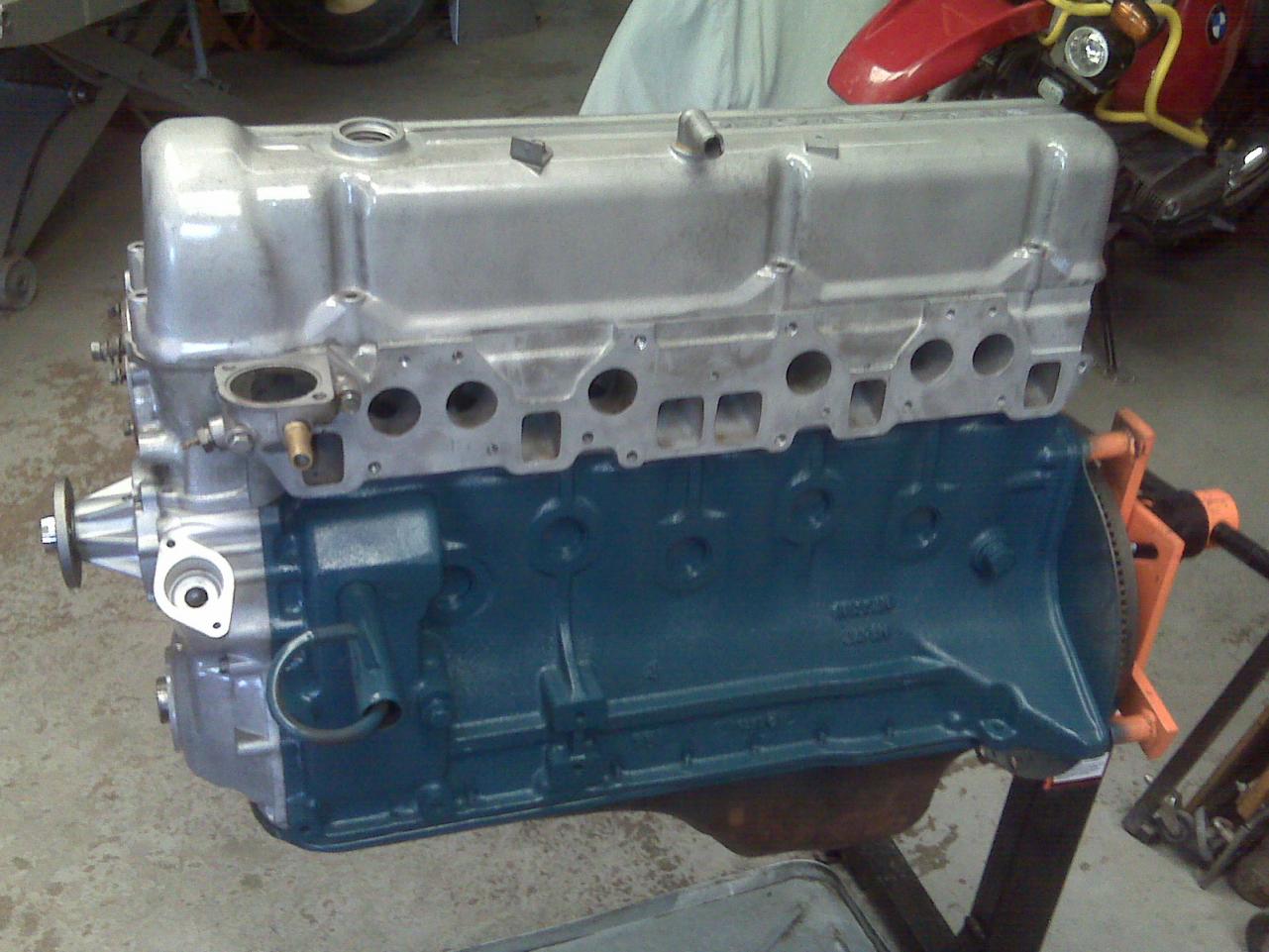

I am actually getting a little closer to completing what I originally set out to do, change the head gasket,although that got a bit out of hand as well and of course the rest of the car is completely apart. Oh well maybe I can drive it next summer.

That happens to everyone so don't feel too bad. "While I'm at it" will be the death of all of us LOL
Your engine build looks really clean!
Instead of changing the head gasket I ended up re-building the entire head,new timing chain and gears and all, you know,while I'm here and its such a long way back to it later!
Parts are just stacked for now,still have to do the oil pan
