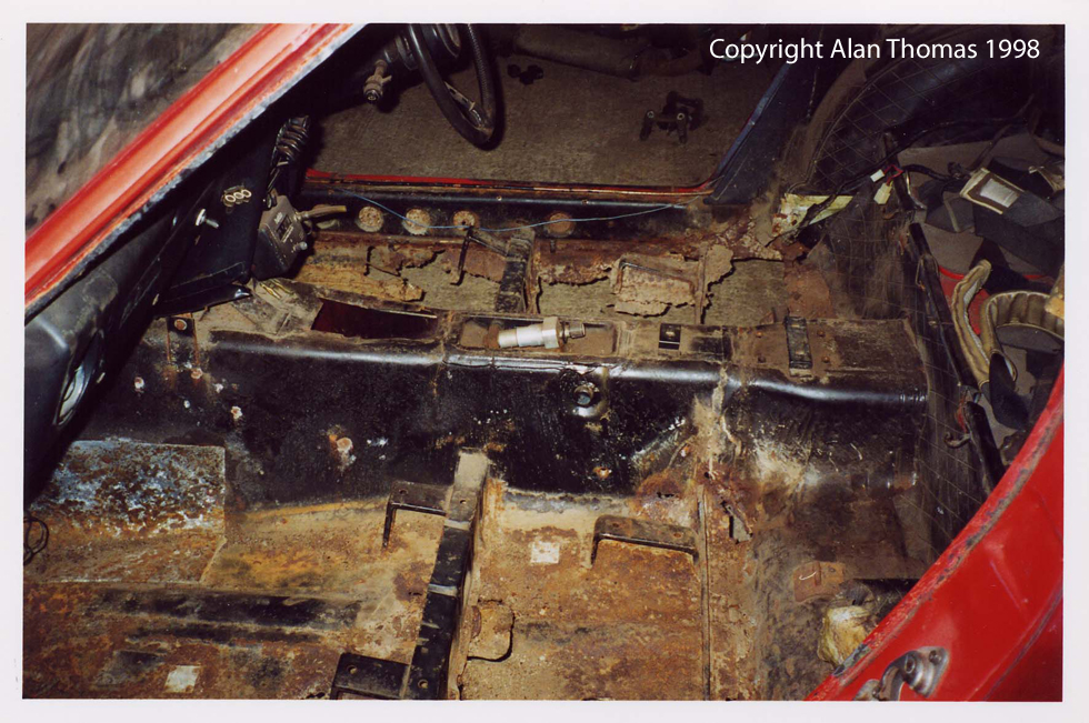

July 1, 200916 yr comment_288500 I might start to consider writing something like a book...when I start to believe I know where the bottom of the research trench is. Every time you find some new information it brings up more questions and more possibilities for research, so it is endlessly fascinating but also endlessly frustrating. Alan,Take a stab at it. History is something you will never get your arms around and no one expects you to. Documenting the one car would be a project by itself however well worth the effort.But just looking at the floor picture has me thinking of questions already! I see what you mean.Chris Link to comment https://www.classiczcars.com/forums/topic/32332-works-rally-240z-resto-featured-in-octane-magazine/?&page=3#findComment-288500 Share on other sites More sharing options...

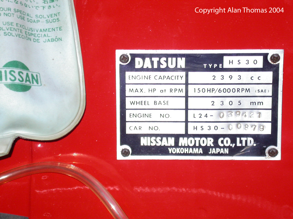

July 19, 200916 yr comment_289973 So the car is stamped PS30 and not HS30 right? It left the factory as a 432? Or was it stamped HS30 but built using the techniques of the 432? The article in the magazine went some way toward explaining it but didn't go into detail. Link to comment https://www.classiczcars.com/forums/topic/32332-works-rally-240z-resto-featured-in-octane-magazine/?&page=3#findComment-289973 Share on other sites More sharing options...
July 20, 200916 yr Author comment_289998 So the car is stamped PS30 and not HS30 right? It left the factory as a 432? Or was it stamped HS30 but built using the techniques of the 432? Gav, These 'early' ( pre '72 season regulation change ) works cars were put together using some of the special pressings and panels that were originally created for the 432R ( as opposed to the 432, which had 'normal' panels and pressings ). So the rear quarters, roof and other panels were thinner gauge steel than 'standard' 240Z / 432 / Fairlady Z versions, whilst some of the more structural sections ( including inner and outer sills and the box sections at the rear of the car ) were thicker gauge steel than 'normal'........ Most of the FRP panels hung on the car ( bonnet / hood, doors and tailgate ) and the acrylic windows were parts originally introduced as stock and / or 'Sports Option' parts for the 432R, although there were some subtle differences due to the special conditions and needs of stage rallying ( rear window mounting, for example ). Even the seats in the rally cars were 432R type items - although some of the works rally cars ( including '3640' ) used a special reclining seat for the navigator, which was a concession to the nature of events like the Safari and the RAC in those days. Sometimes a driver would catch some rest in the navigator's seat whilst the navigator drove a road section...... So you could argue that these early works cars were essentially 'PZR' type bodies, but using L-gata mechanicals and stamped up with series production 'HS30' and 'HLS30' prefixes and body serial numbers on their firewalls and engine bay tags. They really were quite special. Here's the engine bay tag from '3640', to illustrate: Link to comment https://www.classiczcars.com/forums/topic/32332-works-rally-240z-resto-featured-in-octane-magazine/?&page=3#findComment-289998 Share on other sites More sharing options...
