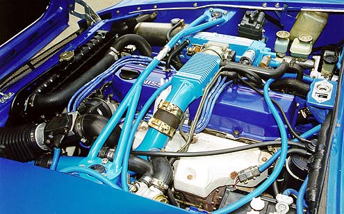

An RB30 shouln't be any more difficult to fit than an RB26.
Heres a pic of a 240z with a RB30ET (from a VL commodore), which has the intake pipe on top of the engine and the bonnet shuts ok. This car was in Street Machine magazine a while back. I dont know who owns it, but this pic was taken at the z car workshop.
Mr C
