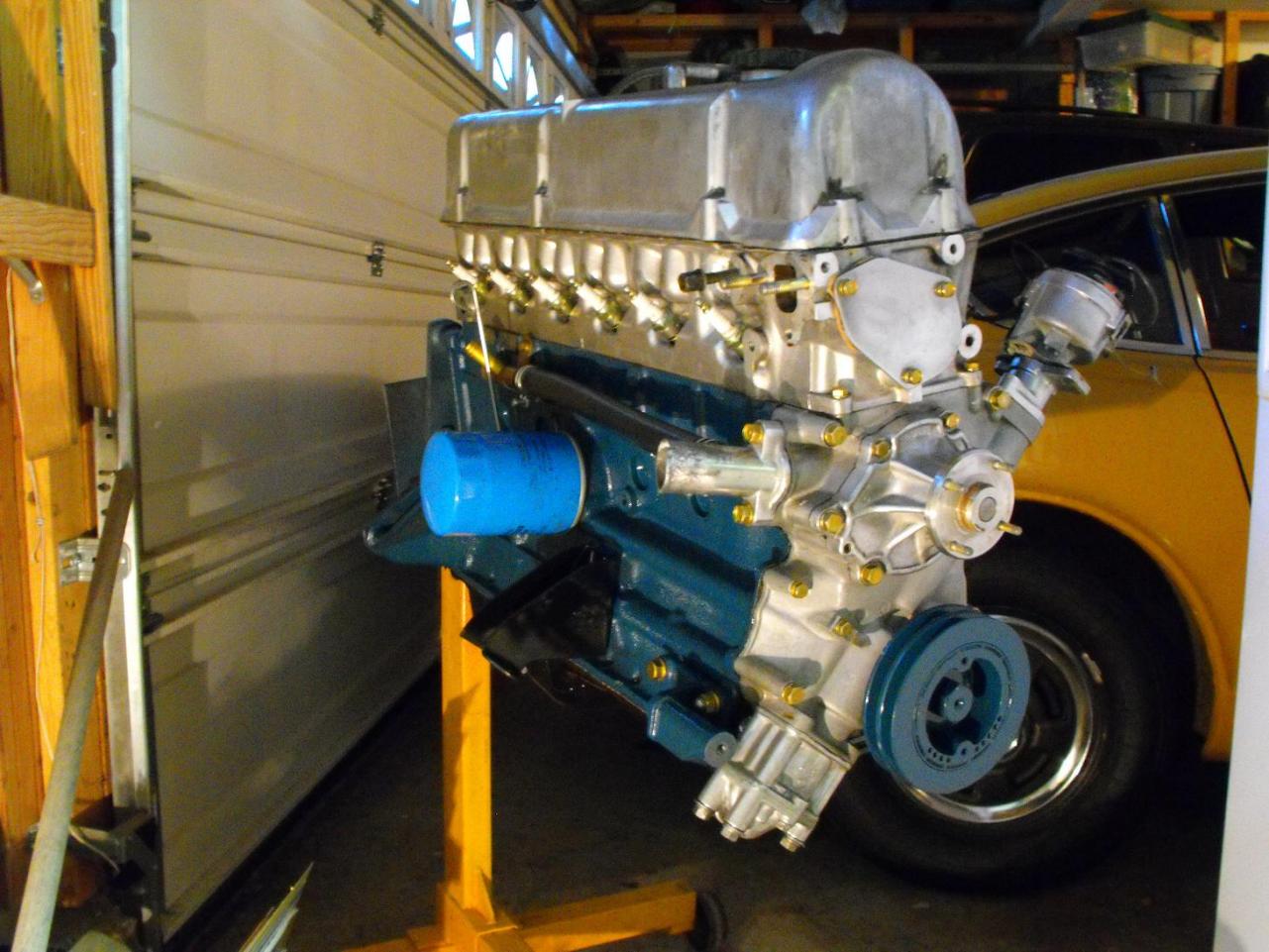

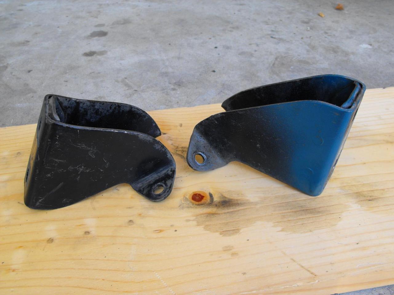

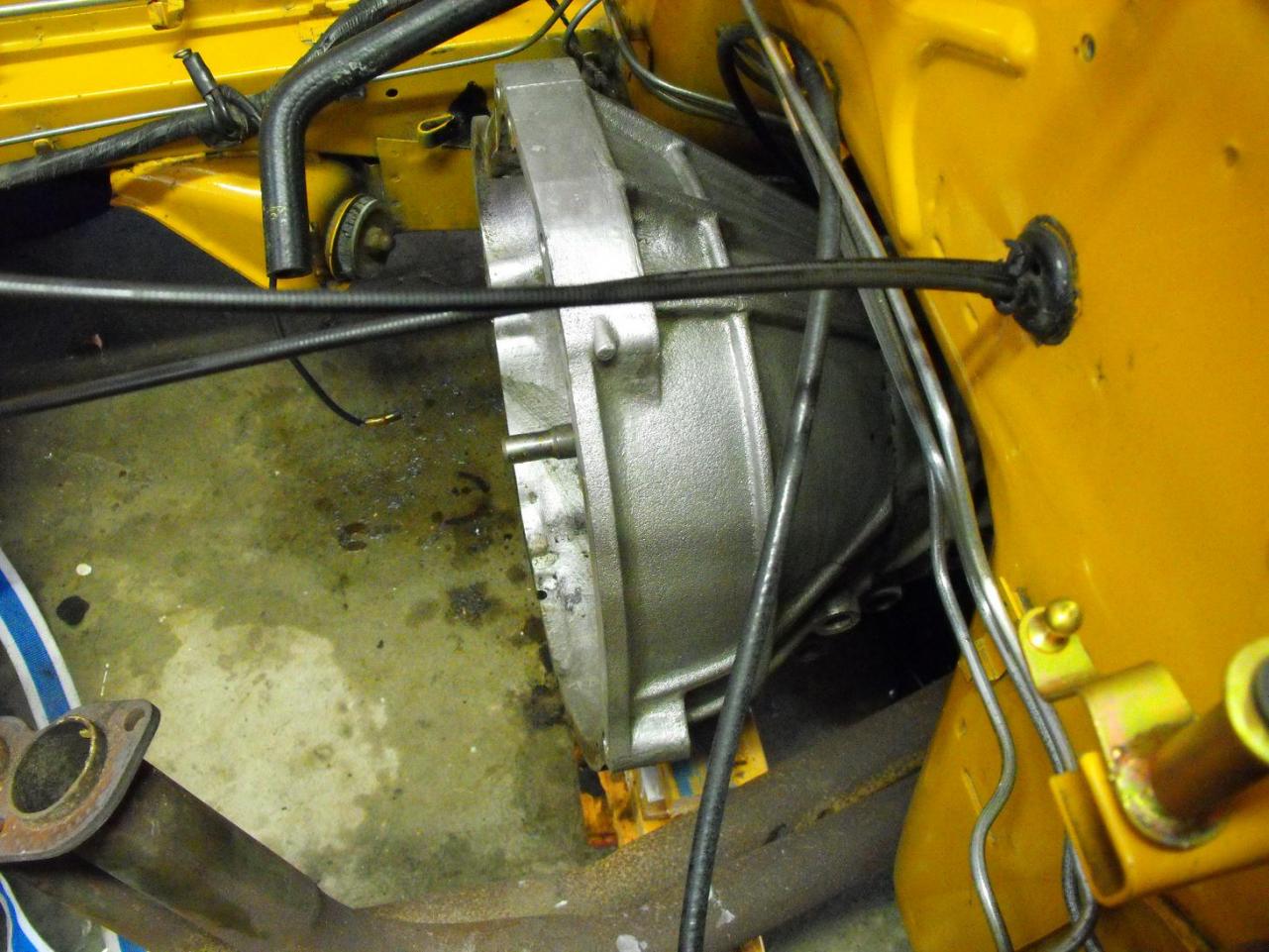

June 29, 200915 yr Author comment_288220 Thanks for the compliment. Really, this has become a 'labor of love'. I am really enjoying every minute of the cleaning, polishing, assembling, etc. It's very rewarding to see the great results of all the effort. It's also a tremendous learning experience. It has been a long time since I've pulled an engine. The engine is assembling well and looking good. I spent half of the last two days assembling and the other half cleaning. I cleaned the brake lines and coated them with clear enamel. Also cleaned the transmission bell housing. I will clean the electrtical harness (I am thinking soap and water for that) and then I will be about finished. I should be able to drop the engine back in toward the middle of the week. Below are some pics of the transmission, brake lines, pre-painted (original paint job) motor mounts, and engine build-up. Link to comment https://www.classiczcars.com/forums/topic/32197-1970-z-refreshbiting-the-bullet/?&page=7#findComment-288220 Share on other sites More sharing options...

June 29, 200915 yr comment_288229 Hi Rich:That is simply beautiful... what a jewel you have there.Looking at the picture - I would highly recommend that you get a new set of Tension/Compression Rod bushings and replace the originals. The originals look to be very cracked...The Tension/Compression Rod plays a critical role in the stability of the front suspension. Left worn and not doing their job, puts a great degree of additional stress on all the other components of the front suspension. The T/C bushings are very easy to replace and I'm pretty sure you can still get them from the Nissan Parts Dept.FWIW,Carl B. Link to comment https://www.classiczcars.com/forums/topic/32197-1970-z-refreshbiting-the-bullet/?&page=7#findComment-288229 Share on other sites More sharing options...

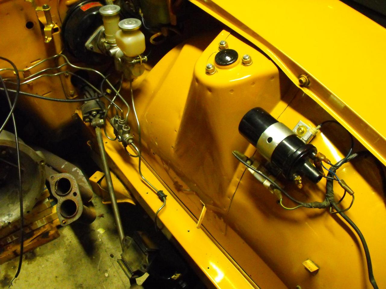

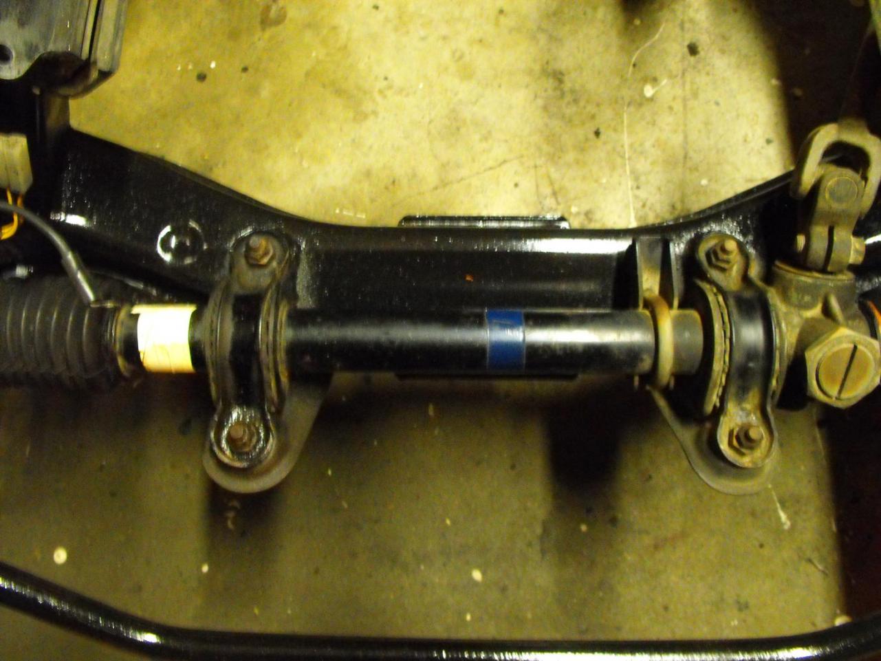

July 2, 200915 yr Author comment_288563 I am starting to put things back together. Both sides of engine bay cleaned up nice and are ready for parts. I need to figure out how to clean or replace the yellowed electrical terminal coverings. I am thinking I can buy new ones (somewhere) and recrimp the contacts. Also, white and blue tape on the Rack steering mechanism. I believe it is factory, but not sure why it is there. Does anyone else have this? Same colors? Rich Link to comment https://www.classiczcars.com/forums/topic/32197-1970-z-refreshbiting-the-bullet/?&page=7#findComment-288563 Share on other sites More sharing options...
July 2, 200915 yr comment_288568 Pull the steering rack bushing caps and replace the steering rack bushings.....while you're at it, clean and paint the caps and replace the nuts with new cad nuts. We love to find new projects for you! It looks just fantastic! Link to comment https://www.classiczcars.com/forums/topic/32197-1970-z-refreshbiting-the-bullet/?&page=7#findComment-288568 Share on other sites More sharing options...
