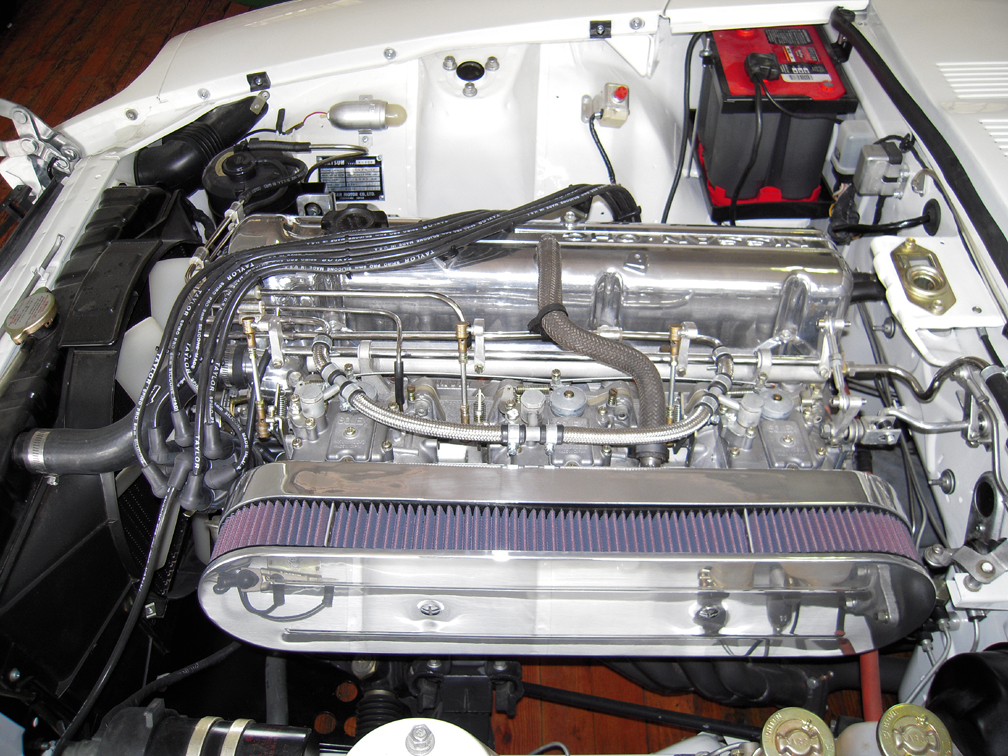

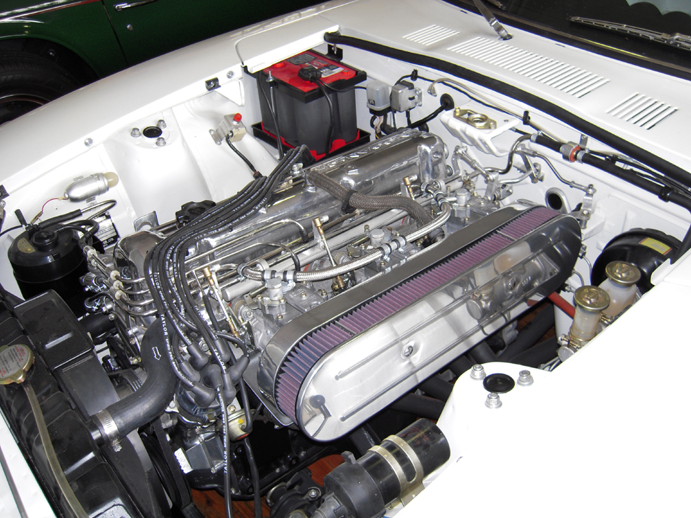

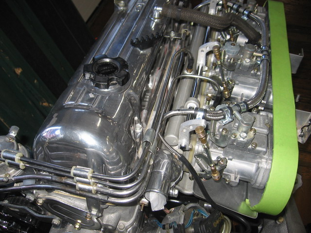

The photos show setup 2 utilizing the original fuel rail brackets with a vacuum line and canister purge to the balance tube.
Fixitman
Fixitman
nice. i also see that you found a way to hook up the carbon filter. i was having a problem finding a way to hook up my carbon filter t the carb system. i only have two rails though.
i got the carbs in. im gonna go out to the the local performance shop monday to get fuel lines and see if they have some T fittings to run setup #2. also after seeings fixitmans post im gonna try and hook up my carbon filter the way he did.

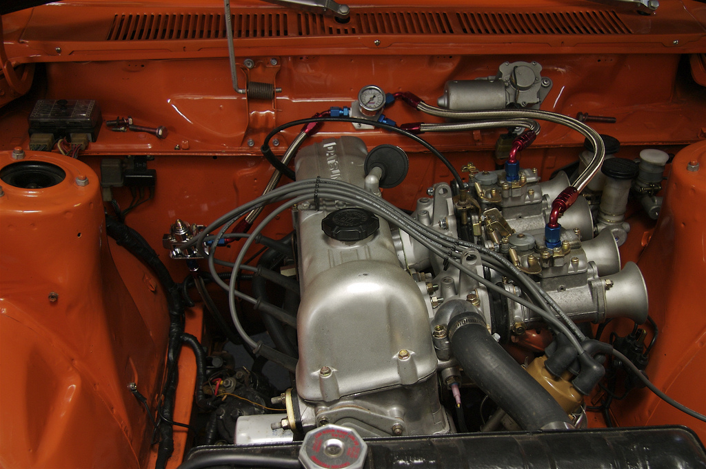

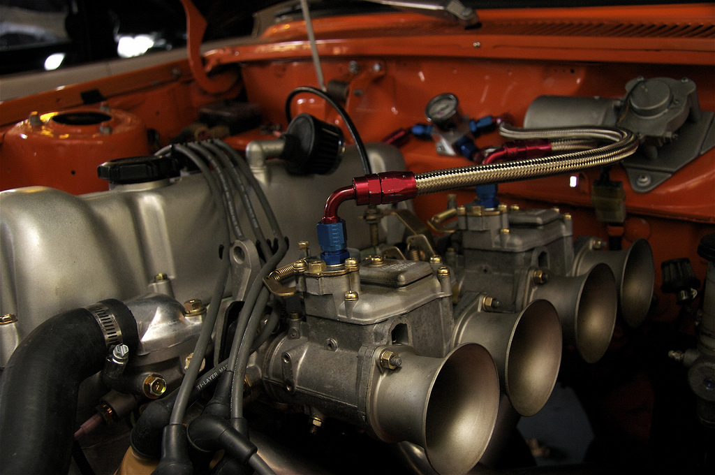

I have twin mikuni 44's in my 510. I am running a low pressure Carter electric fuel pump near the tank. Aeroquip 6 stainless line with anodized fitting. It goes from pump to a Holley low pressure regulator. From there the single line goes to a Y distribution block with a fuel pressure gauge. Then one line to each carb.
How would I do a return in this system? Could I use the older small hard line that was the feed as the return? I am just unsure the best way to plumb it into the system.
