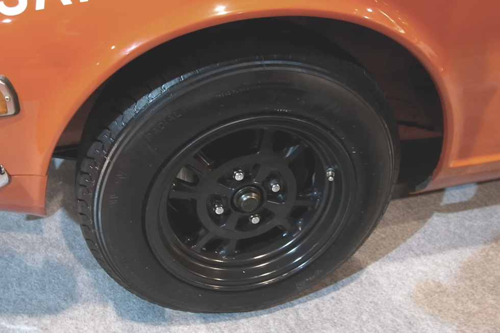

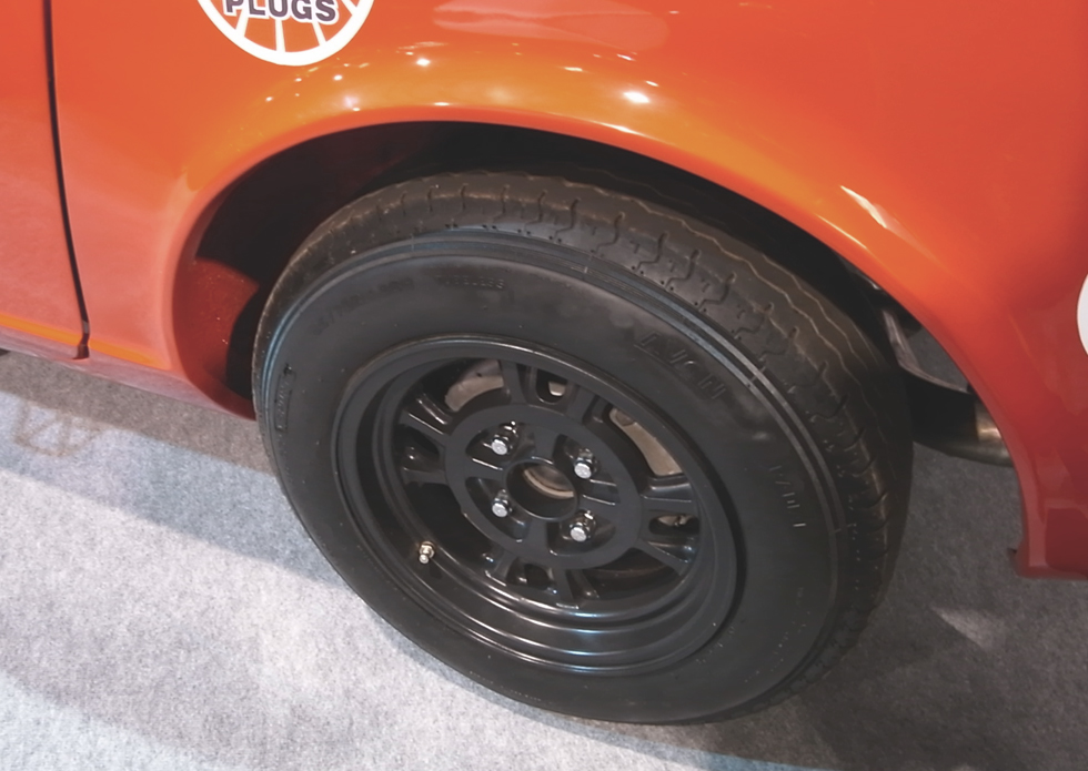

Fred, here are some pics of the 185/70-R14 Avon CR6ZZ on 7j wheels. I don't think that they look particularly 'stretched', and the sidewall still extends out beyond the rim of the wheel. They should still work OK on your 7.5j.
