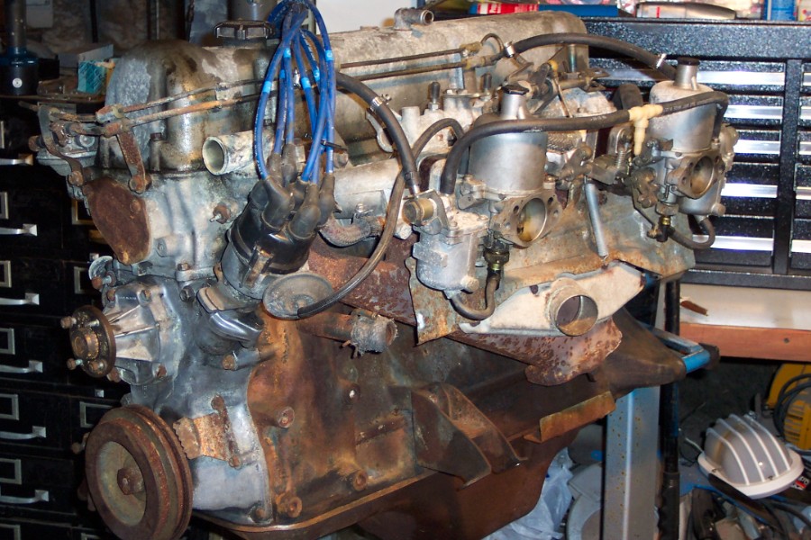

Hi Folks, I am almost to the point where I can focus my attention to my carburetors. Been doing some surfing around this and the ZTherapy site because I'm leaning towards rebuilding them myself with Ztherapy's kit/video.
I haven't seen any downside to doing busness with them but I haven't talked to them yet either. On their website they mention the "rare" 3 screw carbs with a float bowl drain plug". I think this is what I have although the PO told me they came from a 72. (he also told me there was no rust :))
Can anyone clarify this for me? What do I have here and are there any issues rebuilding these?

Is that out of a MA seacoast car? Looks like the engine has been around the world underwater...... ROFL
Anyway the carbs are vanilla Zcar carbs. Call with a credit card and we'll get a tune up kit coming. 503-587-9800 Our JUST SUs DVD will walk you through the process.
There may be a typo on the ZT site. The rare (or perhaps 'uncommon' would be better) carbs are early 4-screws w/o float bowl drains. Used on '70s only, probably the first 6-7000 cars.
What do you mean underwater? Isn't that what everyone's engine looks like???
Fortunatly it looks worse than it actually is. I have since taken it apart and blasted and painted and clearcoated everything. so it looks much better now and I'm hoping the clearcoat will protect everything from our salt air erosion problem here in Gloucester.

I was going to comment, as I began to read this thread, what Arne pointed out. 4 screws / no float bowl drain plug. I'm thinking I have collected four sets and I'll be in touch with Mr. Palmer.
Getting back to the fish-of-the-point, a tune-up kit should bring marked results. These carbs can be fun to rebuild. They are not difficult and IMHO, ZTherapy has the best deal going.

His picture is exactly what my engine looked like when I started rebuilding my car. It's a "heavy salt in the long cold winter" thing... Which is why my car stays parked indoors all winter unless there is a really heavy rain followed by a warm spell. (Like last week.)
