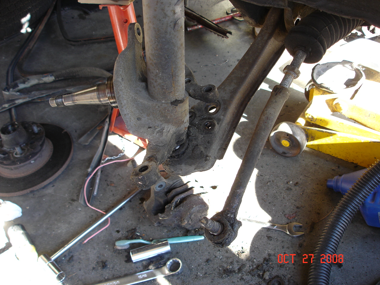

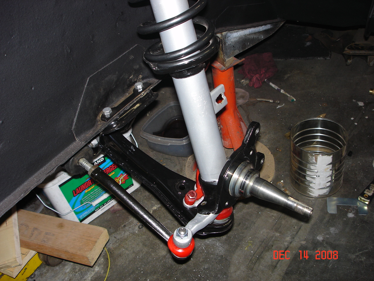

EVERYTHING is getting Urethane in the 260Z. I just want all the hard work to last and not have to be readjusted every year do to wear and tare. Don't get me wrong, rubber works and can last for years, but the rubber I removed from the 260Z was Trashed and should have been replaced 20 years ago.

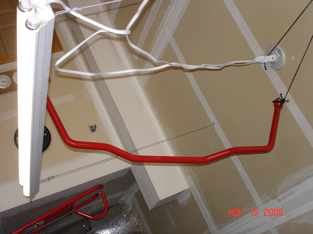

I forgot to mention the Sway bar bushing in my previous post. They are very easy to swap and a great place to start. The rubber factory doughnut bushings (on the end links) tend to split, tear and make the front end sloppy. It's as easy as buying new end links and poly bushings, that come with 2 new grade 8 bolts, nylon lock nuts and new washers. The stock ones tend to rust and deteriate and can "Snap" or bend if put under too much tension.
If you stick with the stock size sway bar in the front, the body mount bushing is easily replaced. If you go with a larger bar, make sure you order the larger bushings and new body mount brackets. The larger bars urethane will not fit in the stock bracket.

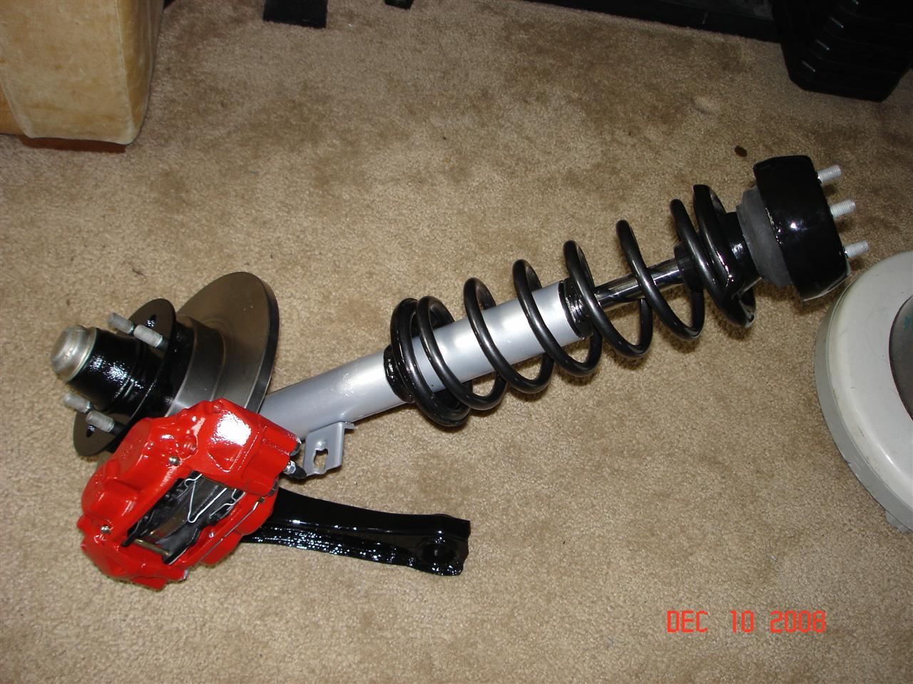

I did'nt take pictures of every upgrade so make sure you take plenty of before and after pics, both for us and your personal folder. You'll love showing off the end results of "Before and After"
Dave.
Here's a couple before and afters and the new 25mm front bar. just for your viewing pleasure.
