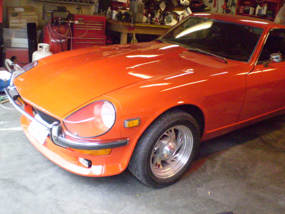

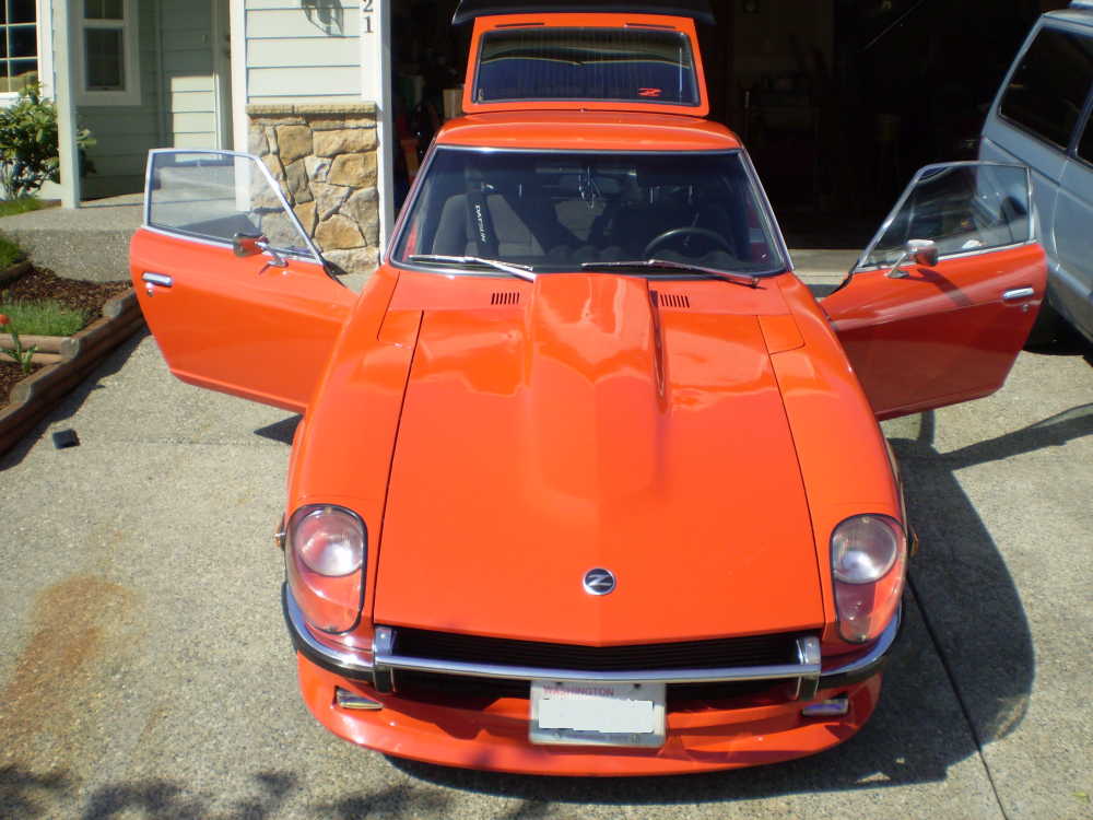

First, no, there was not a matching right side mirror. Yes, you can mount a left mirror on the right side, but the angle of the stalk is then quite different. The left mirror is not symmetrical that way.
They only made the left side mirror. But, I too purchased an extra left side and "Flipped" it.
The only problem with it is you have to shave the upper part of the mounting foot to correct the angle on which it sits. The left side mirror has a slite (maybe 5 degree) angle, when you put it on the other side, that 5 degrees turns into 10 degress and the mirror sits outward, or away from the door.
Use a peice of tape to mark your line with about 1/8" to be ground off the upper part. Degressing down to 0" at the bottom part. You'll basically shave a wedge shape off.
Then Twist the mirror 180* while holding the neck of the mirror.
You can see in the below pics that the angle looks the same on both sides after the shaving. Most people Never notice mine because they never think to look for a right side mirror, and they blend so well .
