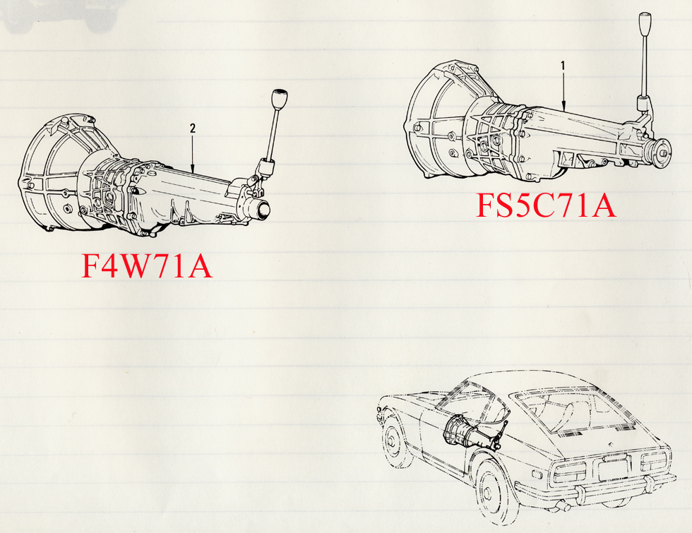

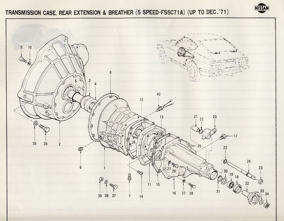

These illustrations ( especially the 4 to 5 speed 'A-type' box comparison ) might be useful too, I hope:

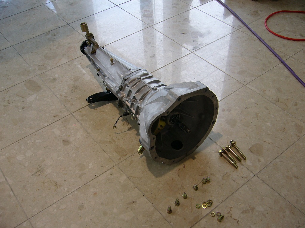

I do not know this can be helpful for your question,I attached the FS5C71-A of my Z432.
The housing of the clutch plate area is different,but I think others are the same for L-series engines. To look carefully around shift lever basement is the good point of this transmission.
