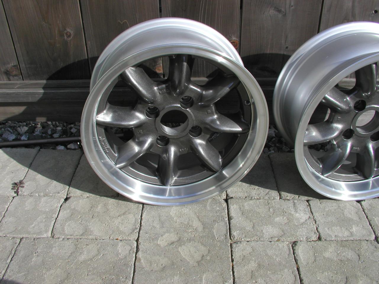

The attached photo shows Bridgestone's RE-960AS on a 15" x 7" wheel. The Tire Rack felt this was the best tire available in the size and catagory. In a few months I'll find out how good they are.

It looks like you've got 15x7 Panasports pictured there (or perhaps Rota RB's?). The Panasports are usually 0 degree, and the Rota's a very close, +4mm ET I believe), so any of the three tire options should work for you (with the 225's could be tight - caveat)
