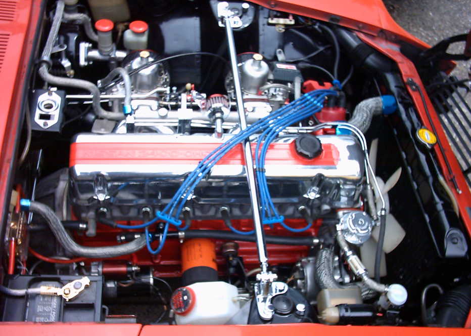

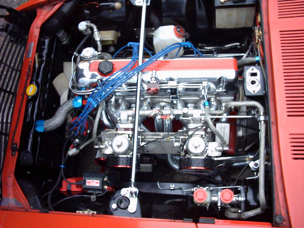

As you can tell from the pictures, I've repeated the process on MANY of the aluminum items in my engine compartment. Schucks, NAPA, AutoZone and many other auto parts stores also carry Anodizing spray in Red, Blue, Gold and some other colors to really make it all come alive and maybe even match some real anodized items on the engine.

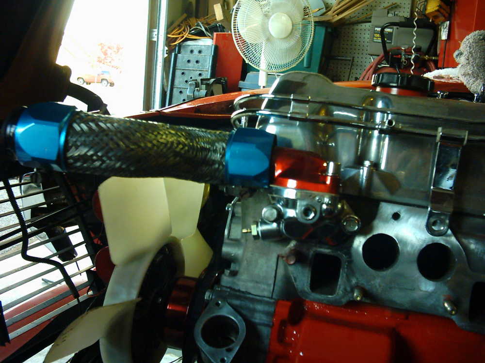

The third picture shows the pulley and water neck after being polished (by me) then sprayed with the red anodizing spray, then clearcoated. As an offset to the blue anodized hose fitting.
