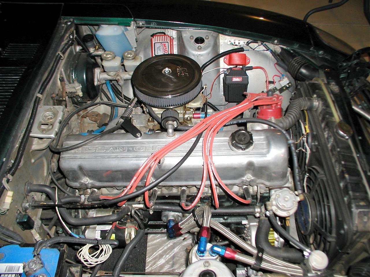

Here's one for reference point. I just tuned up my 4BL 390cfm Holley after installing a new ignition on my 240z. I also had a new clutch installed last week so my driving has pretty much 50/50 = highway/city and very light on the pedal since I'm breaking in the new clutch. I just topped off the tank after the tune up and got 20.5 MPG ! I'm pleased since so much of my driving was on the low end of the RPM/Torque range below 3000rpm and under 50 MPH. I'm anxious to take it on a small trip and get an better estimate of highway mileage. I'm sure my mileage will deteriorate as I push it more once my clutch is broken in. I included a photo of my engine setup and the specs below. Hope this helps.
Specs on my Engine:
- 2.4L E88 Head , P30 Block with Oversized Exhaust Valves (~9.5 : 1 CR)
- 4BL 390cfm Holley with Arizona Z manifold
- MSD 6A (pn 6200) Ignition box
- Mallory Promaster Coil
- Mallory Unilite Distributor
- Magnecor 8.5mm Ignition / Plug wires
- NGK's gapped at .058" -.060" (with the MSD 6A, I get great spark)
