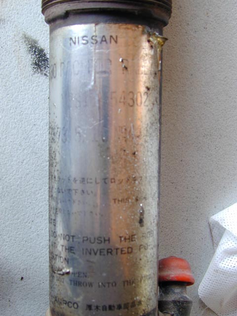

April 8, 200817 yr comment_243396 Carl,Car looks wonderful. Good work! Quick question if I may: What suspension legs / struts are fitted to the car now? Did it survive it's post-BRE life with the correct units, or did you have to track some down for it?I mainly ask because I have a set of four original Sports Option 'rally' legs sitting on a shelf in one of my garages. The stronger ones with the longer tubes, higher platforms and loooong springs. Combination gas/oil filled. Sitting there doing nothing, poor things.Can I also ask - what stopped the car on the original event? Was it a component failure, or something else? I don't think I've ever seen the reason for the car not completing the event - despite good initial pace - mentioned.I saw one of the original Stroppe Broncos in a specialist race prep workshop not too far from my home a couple of weeks ago. The ( American ) owner has just had a new car built to use in mainly European based historic events. Guess what - it's a 1970 HLS30U!Cheers,Alan T. Link to comment https://www.classiczcars.com/forums/topic/27623-found-this-today-bre/?&page=2#findComment-243396 Share on other sites More sharing options...

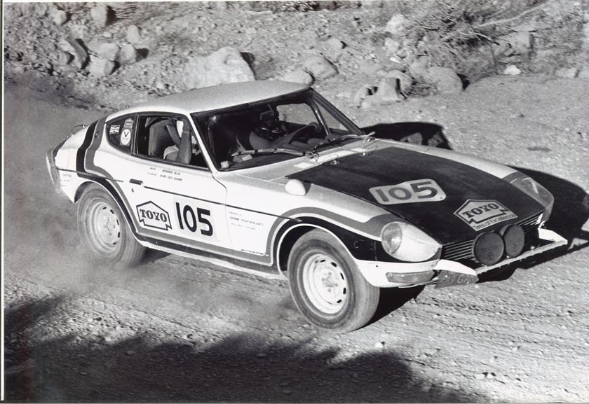

April 9, 200817 yr comment_243482 Carl,Car looks wonderful. Good work! Hi Alan: Thanks... It's been a fun filled project. Quick question if I may: What suspension legs / struts are fitted to the car now? Did it survive it's post-BRE life with the correct units, or did you have to track some down for it?I mainly ask because I have a set of four original Sports Option 'rally' legs sitting on a shelf in one of my garages. The stronger ones with the longer tubes, higher platforms and loooong springs. Combination gas/oil filled. Sitting there doing nothing, poor things. The suspension is the Nissan Sports Option Race Suspension (54302- and 54303-), by Ampco. Gas/oil filled, adjustable coil-overs. The front hub/axles are fitted with tubes for the odometer drives. The original Nissan labels were still on them - although badly faded and beat up. I believe that you said this was the same suspension set up ran on some of the EAS Rally Z's. (label below). According to Dr. Logan, the man that bought the car from BRE in 74, the suspension hasn't been changed since he bought it. However very early pictures of the car do not show this suspension... so BRE may have ran the Rally Suspension at first, then converted to the Race Suspension... Or the early pictures were for publicity, before the car was actually completed. Mr. Brock said he really didn't remember any other suspension package, other than what is on the car now... I'm still trying to figure out exactly what happened. Documents from Nissan Motors mention parts special ordered from Japan, as well as the competition budget spent on the car, but are not specific in detailed part numbers ect. - Mr. Brock seems to think the present suspension is what they ran... Fritz seems to recall wanting to rework the suspension between the Baja 500 and the Mexican 1000 (aka the Baja 1000). Can I also ask - what stopped the car on the original event? Was it a component failure, or something else? I don't think I've ever seen the reason for the car not completing the event - despite good initial pace - mentioned. What stopped the car? - on the Baja 500 a lower radiator hose leaked pressure - caused overheating - and caused one stop that was photographed in the 500. The guys at TrackSide Photo were near by and they loaned Peter a 5 gallon water jug.... which he has still to return ;-). I don't know what else happened on that trip, all Peter would commit to was "no one had to walk". For the Mexican 1000 race. Fritz Warren ran the car for BRE. Fritz said the front shock tower weakened and the front frame rail was bent slightly (large boulders), that lead to a failure in the steering rack mounts, then the radiator supports let go - letting the radiator interface with the fan.... end of day. At that point, the Baja Z was about 15 minutes ahead of the BRE Baja 510 (they started together)... Fritz tells me that the car was amazingly fast, handled fairly well, but they needed another season to sort everything out on the unibody... While any competition effort is serious, I get the impression that the first year for the BRE Z at the Baja was an initial shake-down run, aimed as much at generating publicity and additional sponsorship as anything else. Of course in spite of all efforts - Nissan dropped factory sponsorship for the Professional Teams in 73 for the US (BRE and BSR). (BRE received their first funding and cars directly from Nissan Motors Ltd. Japan). There were a couple other 240-Z that ran the Baja, and I have no idea of how/where or if they finished the race. Hard to see the names clearly but it looks like: 73 Baja 500 Car #105 Hendrik Blom Hans Ceo Crimm car prepared by Crimm Performance 1970 Mexican 1000 Thiel Motors, Modesto, Calif Car #111 Don Thiel **** Jaggard (shortened version of Richard) Still trying to find more information on both of these... Note: TrackSide Photo copied here with permission. Original Prints can be purchased on-line at http://www.TracksidePhoto.com I saw one of the original Stroppe Broncos in a specialist race prep workshop not too far from my home a couple of weeks ago. The ( American ) owner has just had a new car built to use in mainly European based historic events. Guess what - it's a 1970 HLS30U! I've been contacted by a couple of guys that were preparing 240-Z's for historic events in Europe. They were looking for information about the Baja Z - how it was prepared, what components were used and documentation etc. When it came to the Baja - Stroppe's vehicles were always very well prepared. Lots and lots of experience there... FWIW, Carl B. Link to comment https://www.classiczcars.com/forums/topic/27623-found-this-today-bre/?&page=2#findComment-243482 Share on other sites More sharing options...
