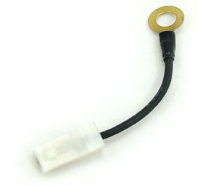

I've been digging all evening, and not found any posts that list the rating of the fusible link on my 1973 240Z. I need to replace the link between the battery and the starter. Ran the battery down and had to jump start, which burnt out the link. You can't buy this thing for less than $25, and only at Courtesy, so far as I can tell. I refuse to pay that for a short little wire. The reason you pay so much, instead of building your own is two things. 1) One end of the link has an extra wide plug on it, that you can't buy in the store. 2) You can't find out what the failure amperage should be.
I was able to get it going again by wiring in a 30amp inline fuse. I tried a 20 amp fuse, and it blew. I used the old wide plug and soldered it onto my inline fuse, so that I wouldn't have to cut up the factory wiring, just in case I ever buy a real fusible link.
Does anyone thing 30 amps is too high? I figure that the alternator only produces 50 amps or so, and there are some accessories that use 20 amp fuses, so 30 should be about right for that small wire to the starter.
Also, if anyone has a cheaper source of these 1973 fusible links(or that odd width blade connector), please let me know. Thanks! A picture of one is attached.
If it is any help, Banzai Motorworks, www.zzxdatsun.com, lists the links in there on-line catalogue under the title, Customer requests, item #E-28 for 1970-1973 240z for $5.00 each. I have used these from Banzai and they work perfectly, and they would know the amp ratings for different years I am quite sure.
