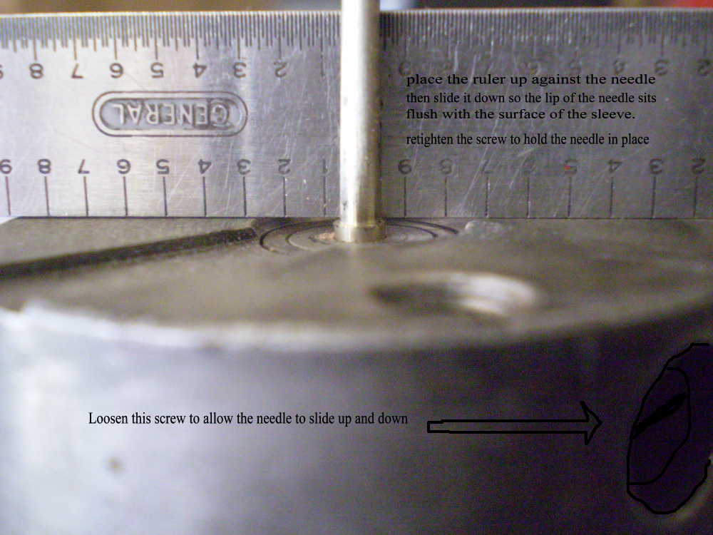

remove the top of the carbs (big round bell shaped peice) and check the seating of the needle. The best starting point is to hold the sleeve (with the needle attached) upside down, with the needle pointing upwards, the needle goes from pointy tip down to a thicker shape, it will then have a flat lip that should be level with the flat surface of the sleeve.

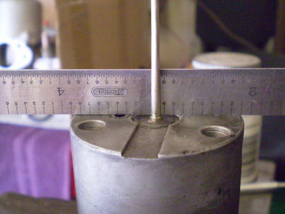

If not, then loosen the screw on the side of the sleeve and use a flat metal plate or ruler to seat it flush and then retighten. Do this to both needles on both carbs and carefully re-install them back into the carbs, while paying close attension to how easy the sleeve rises and falls as you tighten down the tops. then replace the oil that came out when you turned the sleeves upside down.

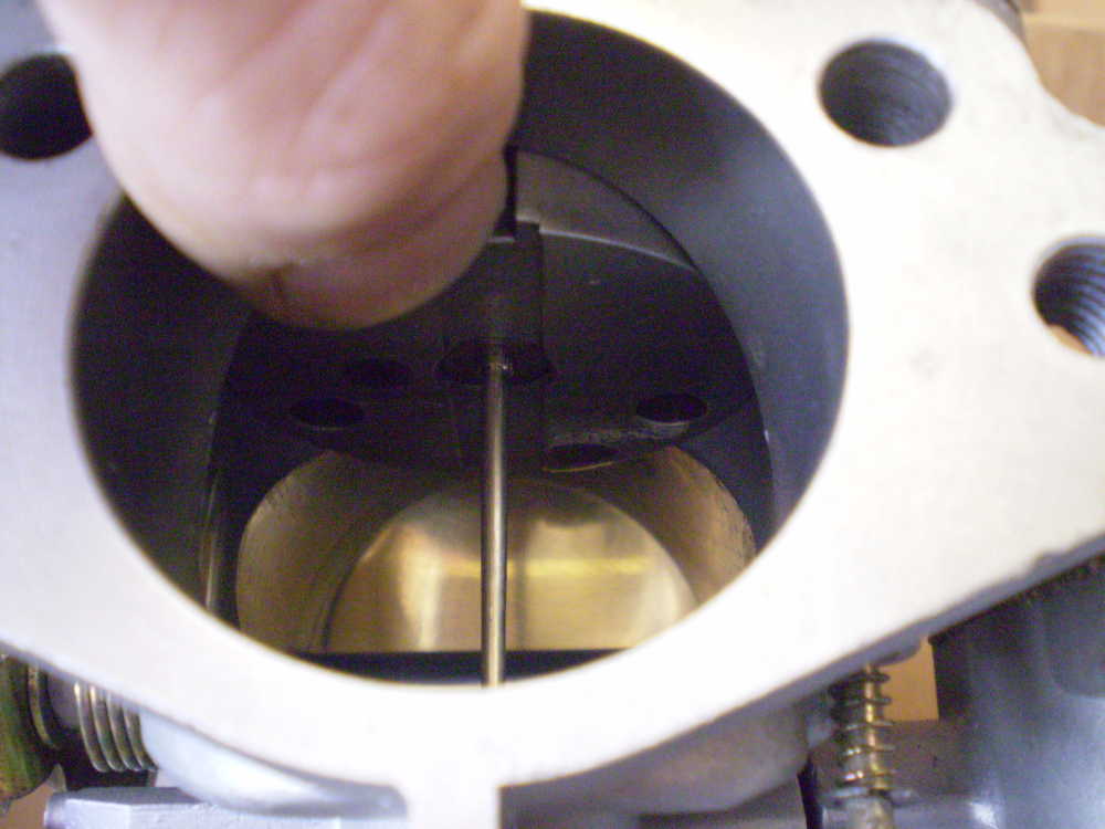

Pics should help
Picture 1 shows how to adjust it,
picture 2 is a decent picture of the same,
picture 3 is showing how to raise and let fall the needle while tightening the top dome down.
