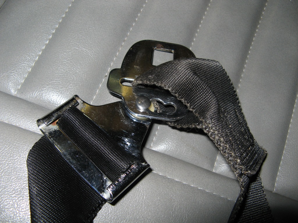

Well i don't mean to sound too dumb but I was wondering how the two seperate pieces of the seat belt come together. If someone could post a picture i would gladly appreciate it.
Different years connect differently. What year are you asking about?
I'm assuming you're wondering how the shoulder belt portion connects to the lap belt. If you're wondering how to fasten the seatbelt then you might be beyond help.LOL
There's a slot on the metal "tab" end of the lap belt. You have to kind of move the webbing out of the way to see it. That's where the shoulder portion attaches.

does it attach to the directly to the metal portion of the shoulder belt? This is for a 4/72 240z

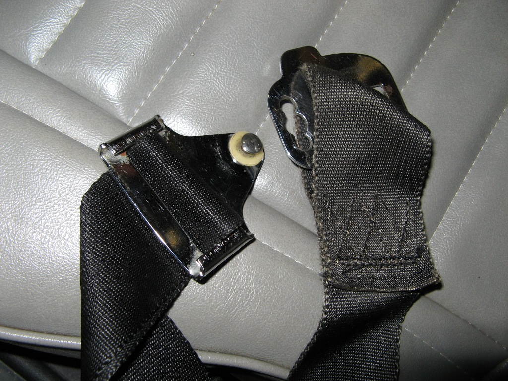

Yes. There should be a small "knob" on the shoulder portion that fits in the slot. I can take some pictures when I get home if needed.
Here are a couple of shots that should make it more obvious.
My car is in the shop getting a new rear differential mount installed. Ive only driven it twice and i really didn't know how to put the two pieces together. (i had the shoulder looped with the lap going through the loop. I was pretty sure it wasn't meant to go that way)
