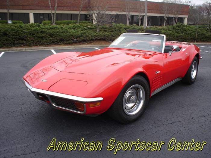

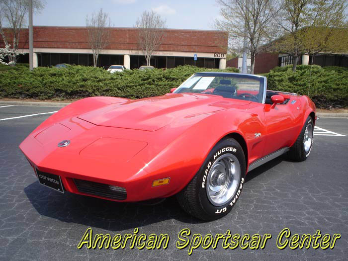

Carl, how did corvettes get away with having fiibreglass front ends then?
The problem passing the MVSS 215 Bumper Standard tests wasn't with the "fiberglass" itself. Fiberglass, pound for pound absorbs and dissipates impact energy better than steel.
The Z had a steel front bumper directly in front of the fiberglass headlight bucket - the headlight bucket was supported only by the thin sheet metal of the front fender horn. When that metal fender horn was bent on impact, it took out the headlight.
Bolting the steel "U" channel at the top of the steel headlight bucket, to the fender horns - strengthened them and prevented them from bending toward the headlight.
For 1973 the Corvette's steel front bumper was eliminated altogether so it could not be pushed back into the headlights. For 1973 being all plastic with reinforcing behind it - it absorbed more of the impact energy, without transferring that energy to the headlight.
