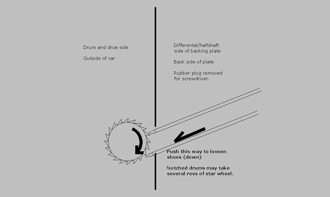

There should be a rubber covered slot in the lower part of the backing plate. (directly below strut) You pop off the rubber and use a flat heaed screwdriver to turn the star wheel. This causes the shoes to adjust inward and eventually allows easy removal of the drum.
The HARD part is when you have drums which are worn and have a lip that holds them to the shoes. You simply have to turn the adjusting wheel a LOT more. The wheel in question is a sawtoothed wheel. To tighten (spread) the shoes farther apart you pry the wheel the "easy" way. This means prying the wheel up. The screwdriver engages the wheel easily because it is catching tooth side of the saw.
To loosen, (what you need to do) you turn the wheel against the saw tooth pattern. See picture. Use a flashlight to verify that you are actually turning the wheel. Check the drum every few turns to see if it is loose enough to come off.
There is a technique using a second screwdriver (small one) to hold the adjuster bar away when you get the first side off play with this technique so you can see how to do it.

just checked to photo on prev post. You can only read it when it's maximized.

Oops!
My picture was wrong. Now that I recall the start wheel can be turned via a hole in the front side of the drum. I'm thinking of some american cars backplates. Sorry.
Just turn the drum 'til the hole is roughly at 6:30 and use a flashlight to find/observe the starwheel as you turn it.
The posts above mention something common which is rust. Soak with hub protrusion with parts blaster and use a soft hammer (rubber/wood etc) to hit the outside face of the drum to unsettle it. If you see movement between the hub and drum but the drum is still stuck you have a lip inside the drum. If the drum is worn and has a lip it is a matter of turning the start wheel enough to slacken your shoes so it will come off.
