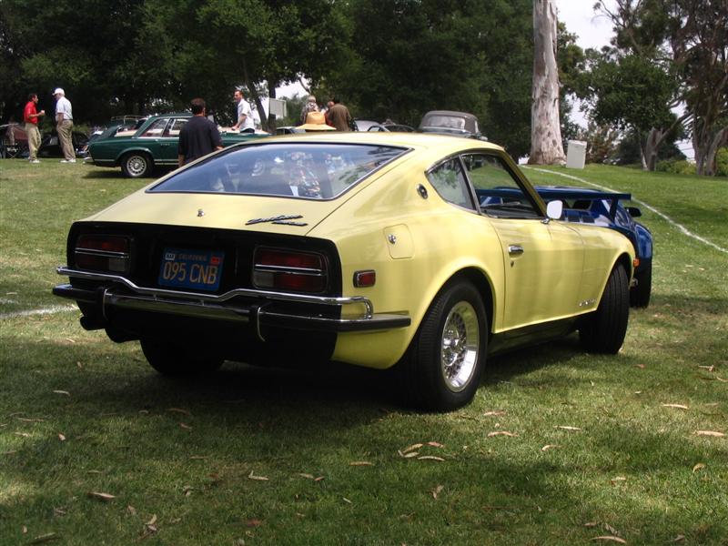

My car has original paint in most excellent condition. I am a member of the yellow Z car club as well. When my father in law purchased the car, he had the dealer shoot the entire tail gloss black. I am trying to figure out if I should have the tail resprayed yellow. I really don't know if I like it black. It seems it was taped off at the corners. If it is resprayed, do you think it will be real noticable as a respray? If so, maybe I should just leave it black.

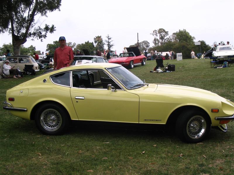

And since I am at it, the rockers are painted black as well, should I repaint those too?
I don't want to respray the entire car.
What to do?
You certainly won't be hurting the originality by respraying these areas. If it is done by a true master of his craft, you will not be able to tell it was resprayed. It's possible to blend the color to near perfection. It sounds to me that you want it as original as possible, so I say do it. That was more of a passing fad then anything, when people painted thier rockers black.
I also agree, Randy. Done right, it should be almost impossible to tell. I'd do the tail, rockers - and if it were mine, the spook as well, as it looks like there is some black accenting on it too.
Thanks Guys, I was unsure whether I could get a match on the paint. It's good to get other eyes on the car and get some learned opinions. The car just doesn't look right with the black tailend. It detracts from the lines of the car when viewed from the back. I have a painter in mind and he has done some good work on company cars for me. But when it comes to the Z, I have a much more critical eye. You are right Arne, the inlets on the spook gotta go as well. They may have looked good in 71 as Ron says, but they seem way out of place now.

The painter said he would paint tail, rockers and spook for $500. That doesn't seem too bad. He also said that it will be diffuclt to spot the new paint as he can match it exactly. I think that I will take it to him to do late this summer. He needs the car for two weeks.

Maybe just paint the lower part yellow I think the tail light area looks good black
