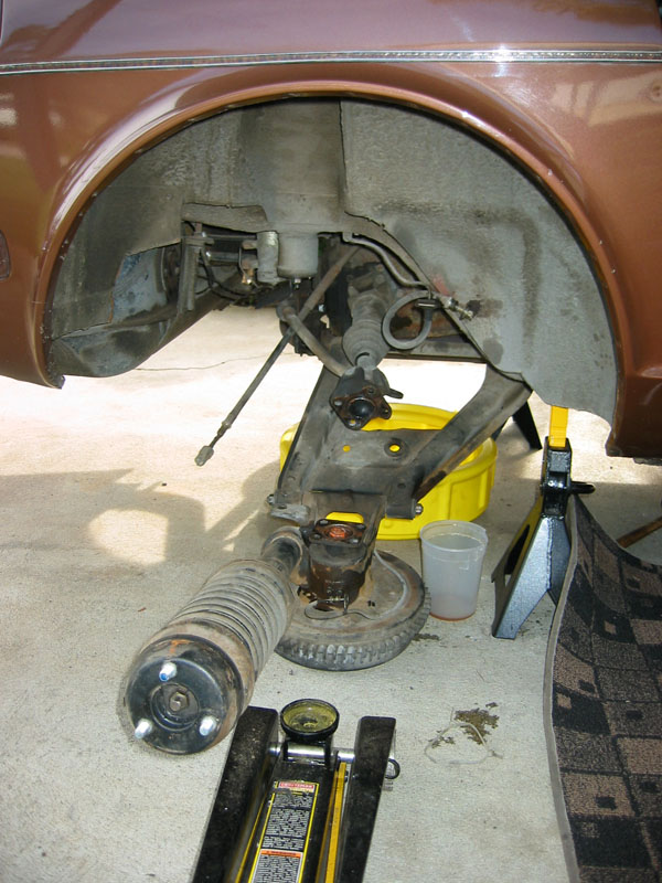

Here's a confirmation for you. I just took off the three bolts on the tower and swung the whole assy down and away. Next step is to use a spring compressor on the assy and remove the nut on the top of the strut insert to dissasemble and remove the spring.

Enigma's picture shows it all. Disconnect the halfshaft, brake line, parking brake cable, and sway bar (on later Zs). I normally disconnect the brake line at the chassis end, and leave the hose connected to the backing plate as it is easier to cap the metal line than trying to plug the hose. Also watch out for the drum, if your brakes are not adjusted tightly it's possible (although not likely) that it could fall off the hub when the strut is pivoted out.
Thanks for filling in the finer points Arne. Note that this picture was taken when stripping off the entire front and rear suspension for refinishing so things like plugging the brake lines or bleeding the brakes weren't a concern at the time.
